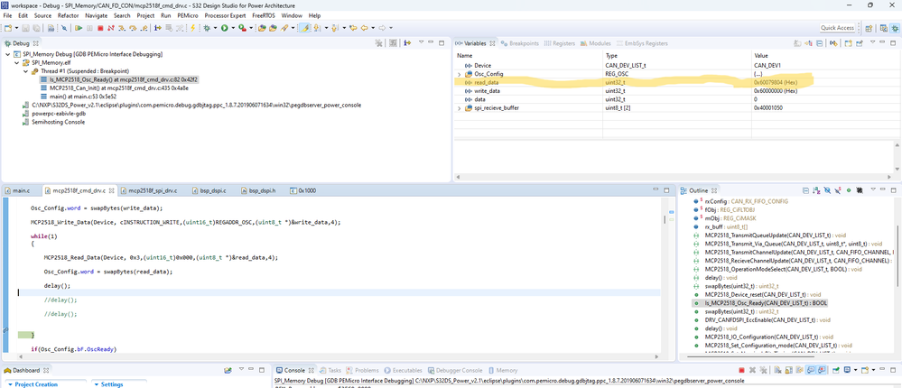

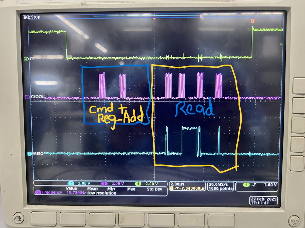

I have a few queries regarding the SPI read function implementation. I am attempting to communicate with a slave device (MCP2518FD CAN extender) via SPI in polling mode at 16.5 MHz.
Issue:
When reading the OSC register from the slave, the expected data is 0x60040000. Upon probing with an oscilloscope, the data on the SPI bus is correct (0x60040000). However, during the software read operation, the data observed in the debugger appears as 0x00600400 instead of the expected 0x60040000. The first byte is always received as zero during the read operation.
Scope Data below is 0x60040000
Debugger window of received data(0x00600400)

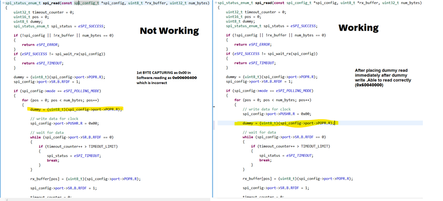

Modified Code:
To address this, I modified the code to perform a dummy read for flushing the RX FIFO immediately after writing the dummy data into the PUSH.R register. This modification resolves the issue, and the read operation now works as intended. kindly check below one
Additional Observations:
Interestingly, other slaves like FRAM and FLASH work fine without requiring the dummy read to flush the RX FIFO placement. After applying the dummy flush placement modification, these other slaves continue to work correctly without any issues, while the MCP2518FD slave now works as expected.
Question:
Is performing a dummy read to flush the RX FIFO immediately after writing dummy data into the PUSH.R register the correct approach? Are there any alternative or recommended ways to handle this scenario?

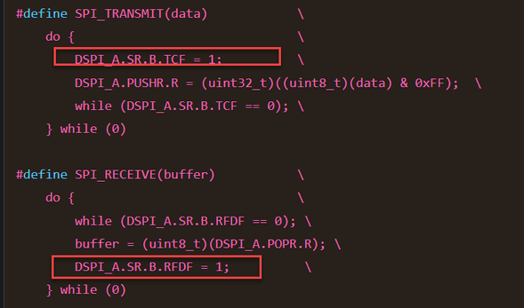

 * @name        spi_read
 * @brief       Reads a sequence of bytes from the SPI interface. The function
 *              supports both polling and interrupt modes. In polling mode, it
 *              waits for the read transfer to complete before returning
 * @Param       p_spi_config - Pointer to the SPI configuration structure.
 * @Param       p_rx_buffer - Buffer to store the received data.
 * @Param       num_bytes - Number of bytes to read from the SPI interface.
 * @return      spi_status_enum_t - Status of the SPI operation (eSPI_SUCCESS,
 *                                  eSPI_ERROR).
spi_status_enum_t spi_read(const spi_config_t *p_spi_config, uint8_t *p_rx_buffer,
                           uint16_t num_bytes)
    uint16_t pos = 0;
    uint8_t dummy;
    spi_status_enum_t status = eSPI_ERROR; // assign with error
    // Read if the SPI configuration, transmit buffer, and byte count are valid
    if ((NULL != p_spi_config) && (NULL != p_rx_buffer) && (num_bytes > 0))
        // Clear any residual data in the rx fifo
       // dummy = SPI_READ_DATA(p_spi_config->port);
        // Clear RFDF Receive FIFO Drain Flag
     //   SPI_CLEAR_RX_FIFO_DRAIN_FLAG(p_spi_config->port);
        // polling mode
        if (p_spi_config->mode == eSPI_POLLING_MODE)
            status = eSPI_SUCCESS; // Assume success unless error occurs
            for (pos = 0; pos < num_bytes; pos++)
               // write data for clock
               SPI_WRITE_DUMMY_DATA(p_spi_config->port);
               // flush rx register ,CLR_RXF is 21st bit
               p_spi_config->port->MCR.R |= (1 << (31 - 21));
              // wait for Receive FIFO Drain Flag.
              // The bit is set while the RX FIFO is not empty
              while(!(p_spi_config->port->SR.R & (1u << (31 - 14))))
                // store into buffer
              p_rx_buffer[pos] = SPI_READ_DATA(p_spi_config->port);
              // clear RFDF flag , RFDF is 14 th bit
             p_spi_config->port->SR.R |= (1u << (31 - 14));
        else // interrupt mode
            // Initialize the SPI reception
            spi_interrupt_buffer.p_rx_buffer = p_rx_buffer;
            spi_interrupt_buffer.rx_length = num_bytes;
            spi_interrupt_buffer.rx_pos = 0;
           // spi_interrupt_buffer.port = p_spi_config->port;
            // send dummy message to invoke interrupt
            // Enable RX FIFO Drain Interrupt
            SPI_ENABLE_RX_FIFO_DRAIN_INT(p_spi_config->port);
            status = eSPI_SUCCESS; // Interrupt mode assumed successful
    // returns spi communication status
    return status;

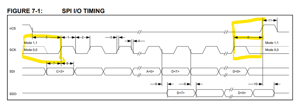

Hi @davidtosenovjan
Should I check the Tcs2sck and Tsck2cs parameters, or are there other parameters I should consider in SPI timings? . Kindly look at attachment of  slave datasheet MCP2518FD DS.book
SPI_Characterstics.pngSPI_Characterstics.pngSPI_Timing_Diagram.pngSPI_Timing_Diagram.pngThanks

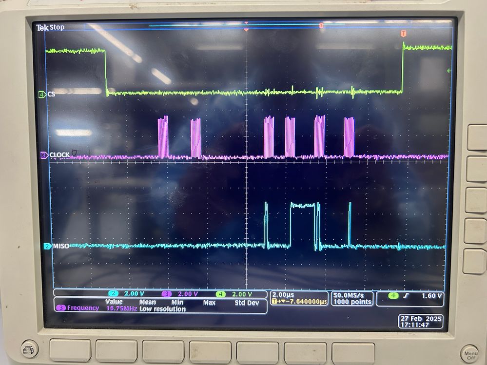

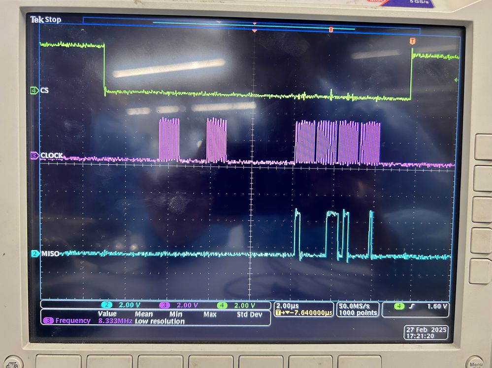

Have you measured all four lines of SPI communication i.e. MISO, MOSI, CLK and CS?
8,215 Views
CNarendra

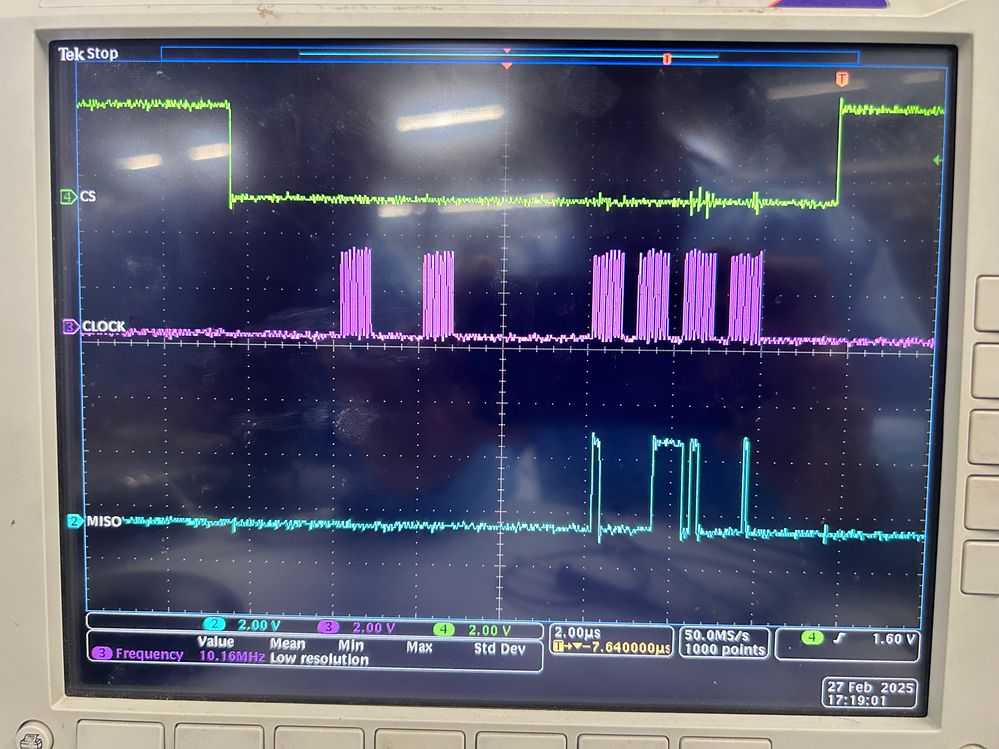

Hi @davidtosenovjan @PetrS,
We captured SPI signals at different frequencies and attempted to read various registers, including the 32-bit OSC and 32-bit C1CON (0x000) registers. We found the C1CON register particularly useful for analysis, as all bytes have some values.
We have set a delay between frame-to-frame using the PDT and DT parameters. We observed a noticeable difference in the delay between frames at 16.5 MHz, 8.5 MHz, and 11 MHz. While the oscilloscope shows the data correctly, the software fails to capture the one byte.
Data Expected to Receive: -0x60079804
Data on SPI Bus  -0x60079804
Data received on Software below 16.5Mhz- 0x600798xy

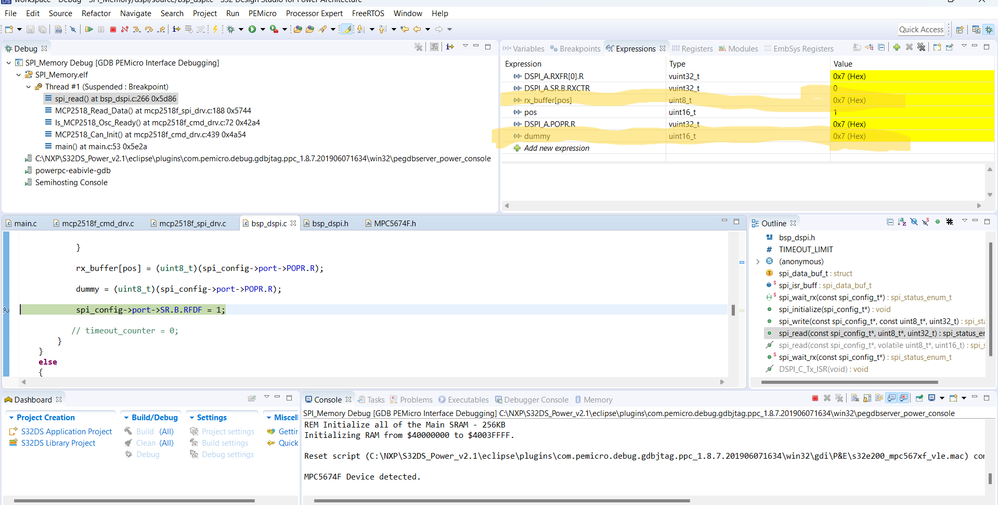

CNarendra
Hi @davidtosenovjan,
I have continued debugging the issue and have been examining the DSPI Receive FIFO Registers (DSPI_x.RXFR[0].R) to track message entries in the RX FIFO. We can see all data correctly in both POPR.R and DSPI_x.RXFR[0].R. However, it appears that one byte—either the first or the last—is being overwritten in the buffer, which is causing the issue.
I am currently investigating the root cause, and I am uncertain whether this is due to compiler optimization or timing constraints from the SPI slave device.
Kindly refer to the attached files for further details.

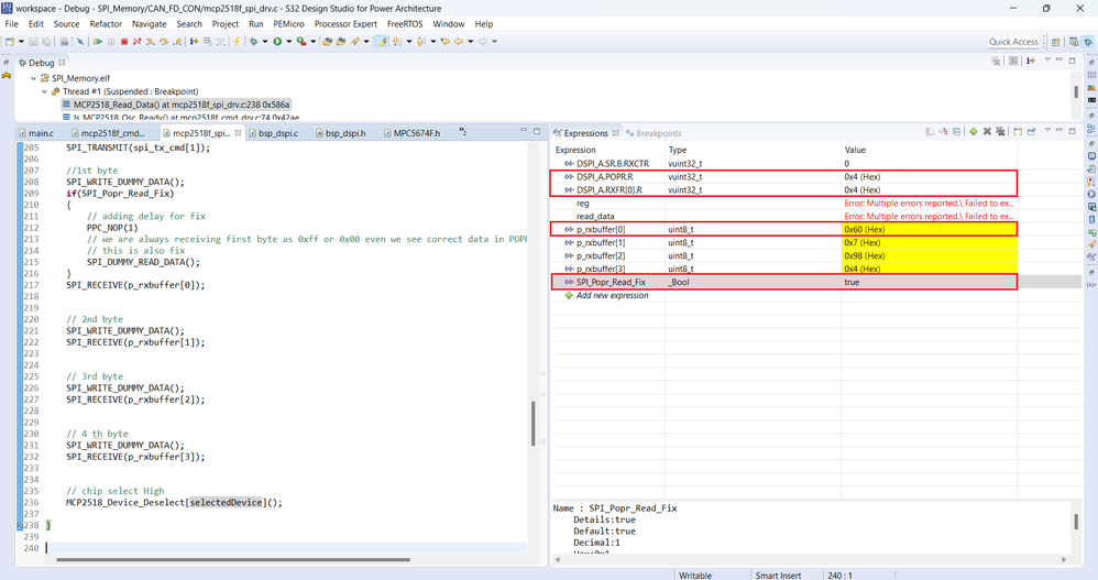

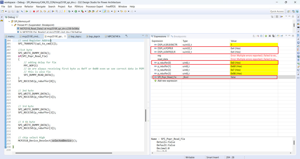

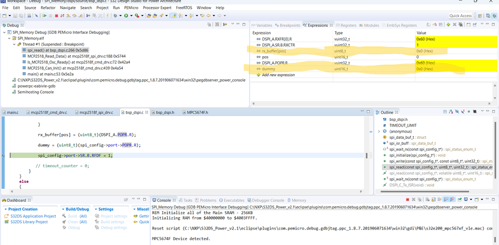

CNarendra
Hi @davidtosenovjan ,
1. As part of debugging ,I added a random delay after the dummy write (for clocking), and now the read operation works correctly.
spi_status_enum_t spi_read(const spi_config_t *spi_config, volatile uint8_t *rx_buffer, uint32_t num_bytes)
    uint16_t pos = 0;
    uint16_t dummy;
    spi_status_enum_t spi_status = eSPI_SUCCESS;
    dummy = (uint8_t)(spi_config->port->POPR.R);
    spi_config->port->SR.B.RFDF = 1;
    if (spi_config->mode == eSPI_POLLING_MODE)
            spi_config->port->PUSHR.R = 0x00;
            // we are adding delay
            delay2();
           // first byte always read as 0xff . we are bypassing here
            // wait for data
            while (spi_config->port->SR.B.RFDF == 0)
            rx_buffer[pos] = (uint8_t)(spi_config->port->POPR.R);
    return spi_status;
void delay2()
   uint64_t i = 0;
   for(i = 0 ; i < 100 ;i++)
2. However, as I mentioned earlier, if I comment out the following line:
the first byte always reads as 0xFF.
We are reading this 0xFF into dummy as a bypass, but the first byte consistently comes as 0xFF across all frequencies.
Kindly help us in giving inputs .This is critical one
Narendra .C

davidtosenovjan
Probably the problem is that you are doing pop operation too early after push operation. Due to that probably RxFIFO underflow happens.
Looking to my example code I did in the past with using of polling method I always did it this way:
PUSH
WAIT_UNTIL_RxFIFO_IS_NOT_EMPTY;
POP
where following macro is defined
#define WAIT_UNTIL_RxFIFO_IS_NOT_EMPTY while (!(DSPI_B.SR.B.RFDF)) {}

I have implemented the suggested changes, but the issue still persists. I also used SPI_Popr_Read_Fix for analysis. The first byte received is either 0xFF or 0x00, even though the correct data is visible in the RXFIFO (debug register DSPI_A.RXFR[0].R).
The first byte in the RX FIFO is not getting updated in DSPI_A.POPR.R (shift register). I have attached a debug screenshot for reference. While using a delay and dummy read has served as a temporary workaround, we need a permanent solution.
Kindly assist us in identifying the root cause and providing a reliable fix.
#define PPC_NOP(x)   {uint8_t n = x; do{ PPCASM(" e_nop"); } while(n--);}
#define SPI_DUMMY_READ_DATA()              ((uint8_t)DSPI_A.POPR.R)
#define SPI_WRITE_DUMMY_DATA()              (DSPI_A.PUSHR.R = 0x00)
#define SPI_TRANSMIT(data)            \
    do {                              \
        DSPI_A.SR.B.TCF = 1;          \
        DSPI_A.PUSHR.R = (uint32_t)((uint8_t)(data) & 0xFF);  \
        while (DSPI_A.SR.B.TCF == 0); \
    } while (0)
#define SPI_RECEIVE(buffer)           \
    do {                              \
        while (DSPI_A.SR.B.RFDF == 0); \
        buffer = (uint8_t)(DSPI_A.POPR.R); \
        DSPI_A.SR.B.RFDF = 1;          \
    } while (0)

    //1st byte
    SPI_WRITE_DUMMY_DATA();
    if(SPI_Popr_Read_Fix)
         // adding delay for fix
	   PPC_NOP(1)
        // we are always receiving first byte as 0xff or 0x00 even we see
        // correct data in RXFIFO(debug register DSPI_A.RXFR[0].R)
        // but DSPI_A.POPR.R shift register value is 0x00 or 0xff
        // here we are reading dummy
	   SPI_DUMMY_READ_DATA();
    SPI_RECEIVE(p_rxbuffer[0]);

Spi read issueSpi read issue
First Byte in POPR.R(shift register) is not getting updated from RXFIFOFirst Byte in POPR.R(shift register) is not getting updated from RXFIFO
Spi Read WorkingSpi Read Working

Don't use .B instance. Petr already mentioned it in the very first response (EB758). It is very important.
8,086 Views
davidtosenovjan
Check status register whether you see overflow/underflow and also check whether you have enabled FIFOs.
6,262 Views
CNarendra
Issue got resolved after enabling FIFO(s) in DSPI
