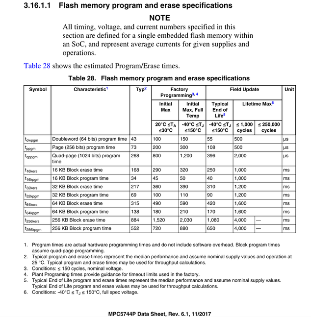

What is the flash erase and write operation time of mpc5744p? I can't find the parameters in the user manual.
In addition, when I do a project of Program bootloader , the upper computer can send 1.5MB files within 80s, but it takes more than 3 minutes to complete the whole Program / download process. What is the reason?
4,192 Views
petervlna
Please have a look at datasheet for it: 3.16.1.1 Flash memory program and erase specifications
This depends on how do you program the device. For some serial communication it depends on settings and HW limits or for JTAG / NEXUS it depends on programmer spec, etc... there can be lot of delays.

XSL-WF
I can't find the programming characteristics in Document Number: MPC5744PRM  Rev. 6.1, 10/2017.
4,161 Views
petervlna
It is because you are referring to reference manual.
the device characteristics are described in data sheet:
https://www.nxp.com/docs/en/data-sheet/MPC5744P.pdf
best regards,
Peter
