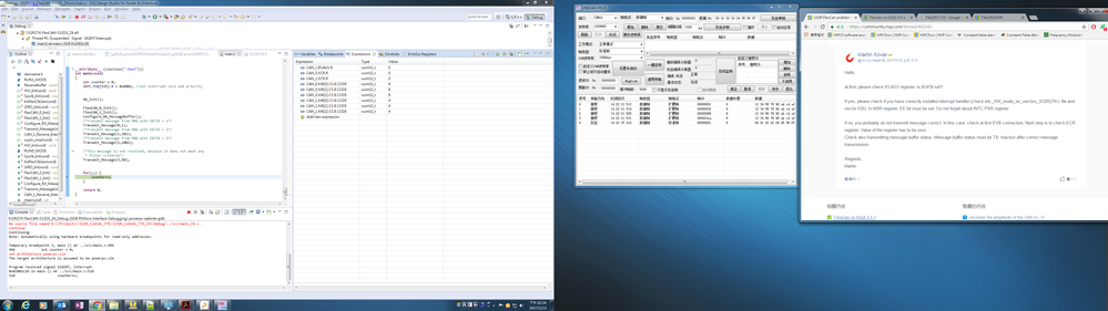

I'd like to try FlexCan function on S32R EVB.
I found Example MPC5775K FlexCAN_with_interrupts_v1.1 S32DS .
I Check S32R274_IO_Signal_Description_and_Input_multiplexing_tables_Rev2,
It seems the same IO between S32R and 5775K.
So I only modified S32R timing in inital.
But it not work.
I saw 5775K set  CAN_CLK at 66MHz, but S32R set CAN_CLK at 40 MHz.
Does it matter?

Follow your suggestion:
I runExample S32R274 FlexCAN_with_Interrupts S32DS.
I can see the TX message  output and I send single frame.
I check CAN_1.IFLAG1.R = 0 mean BUF0I isn't set.
Both of  can0 and can1 ECR = 0;
and Message buffer status are inactive.
How to check EVB connection?
I check R156 on EVB. and it get the signal.
Are there any check points I can try?

I forgot about RX masking configured in my example. I am sending you edited example without RX masking. Please do not forget about extended ID in configured RX message buffers. Now it should work correct.

yi-linhsieh
Hi Martin,
I modified the extended ID to  0,1,2.
and  try to send data  ID with 0, 1.
But CAN_1.IFLAG1.R is still 0;
Is some thing wrong?

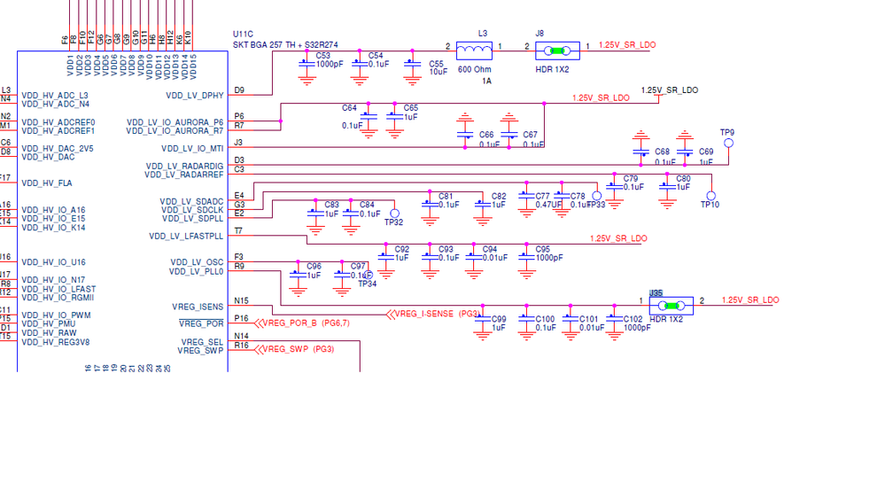

yi-linhsieh
in the header description:
 It is necessary to remove both J35 jumpers.
 Connect J35.2 to PA14 (CAN_1 TX)
 Connect J35.4 to PA15 (CAN_1 RX)
 CAN0 is connected internally to J37 (this pin is placed on daughter card)
 Connect CAN P5.2 to J37.2 (CAN_1 and CAN_0 CANL)
 Connect CAN P5.1 to J37.1 (CAN_1 and CAN_0 CANH)
I can't find P5.2 or P5.2 in  my schematic.(SPF-28921_D.pdf)
and my J35 is on MCU power connection.
Do I need any other doc?

martin_kovar

Regarding you lat post, you have to look at the MPC57xx MOTHERBOARD. I am attaching it to this post.
