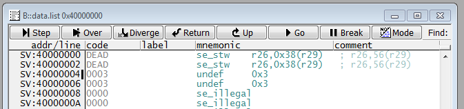

You wrote:
"Actually I've padded whole my unused flash with the following pattern: 0xDEAD."
Just do the same and use 0x0003 opcode.
0xDEAD is recognized as se_stw instruction. 0x0003 is not valid opcode, so it will trigger IVOR6. Simple test:
Lukas
