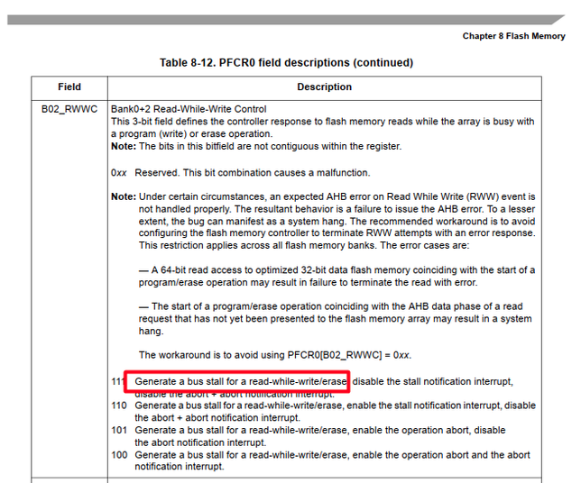

According to the MPC5675K Reference Manual in chapter 8 "Flash Memory", Read-While-Write accesses within a Flash module is not possible. That is, it is impossible to erase or program a Flash sector when executing code from another sector within the same Flash module.
But when I am using the Standard Software C90LC Driver it seems to do exactly that: executing from a Flash module sector when erasing/programming another sector within this same Flash module...
Where is the truth?!
Thank you for your help.

Hi, by default bus stall happens instead of RWW, thus example will run even without relocation to SRAM.
However driver also includes macro COPY_TO_RAM, so you can simply relocate flash routine to the SRAM, what you should do in real application.
