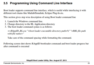

stanish
It has been told to me that there is no any further release of RAppID bootloader planned.
I'm affraid you will have to use a workaround instead of waiting till this feature is implemented.
Please note that RAppiD BL can operate from command line. This mght be useful for scripting/automation of multiple processing steps (such as S-rec merging, read memory, programming)
See RAppID user manual section 3.5
regards,
Stan
