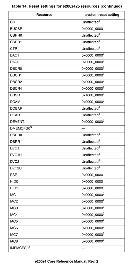

petervlna
Could you please explain what you mean by "fixed areas" ?
You can preserve data by using core registers, or EEPROM.
See core reference manual:
regards,
Peter
