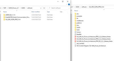

The SDK folder looks like this and is titled _3.0.0

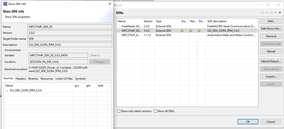

If I right-click on any project created and check the attached SDK - it says:

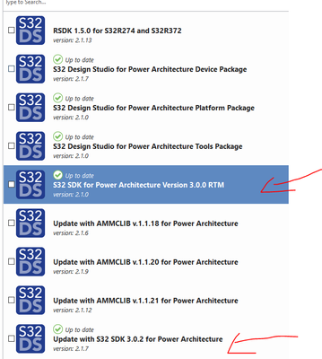

 But in the updates window it says:
 I was of the notion that we were using 3.0.0, but it seems that we did update to 3.0.2 but the title of the folder and attached sdk title still says 3.0.0?
Is this what is happening?

PetrS
if remember well, folder stayed titled RTM 3.0.0 up to 3.0.2 updates.
An update to RTM 3.0.3 adds new folder titled S32_SDK_S32PA_RTM_3.0.3
