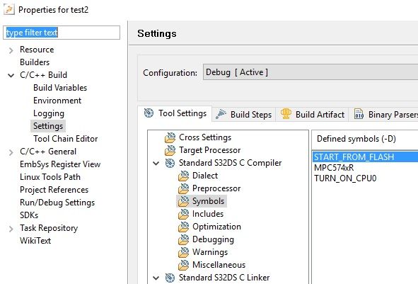

shanescott
Hi Martin,
Your project does perform correctly but I was unable to replicate the result with a default S32 "New S32DS Project" even using the source files from your project.  This made me suspect a difference in the project settings so I compared them and found a difference.  Your project settings contain the symbol TURN_ON_CPU1
The "New S32DS Project" for MPC5743R generates the symbol TURN_ON_CPU_0
Just by changing this symbol manually the PIT interrupt now works with or without debugger for my project.
