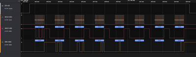

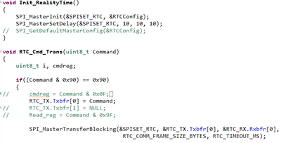

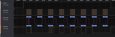

I need some help, I'm using PCA21125 to complete RTC function. I'm able to get communication between 5746R and PCA21125, but the problem is I don't get expected output.

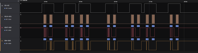

When sended command in 0x92 to get data from second to year as spec described with different methods(fig1~2), I did get something. After compared with spec's data, the item "month" showed 0x00(fig3 showed same result), other items showed "normal" value what if I did right operation to PCA21125, please help me to figure out this problem, thanks.

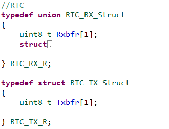

can you give Rxbfr[] value after all bytes are read in one frame (seconds to year)?
Note Rxbfr should hold RTC_COMM_FRAME_SIZE_BYTES bytes.
