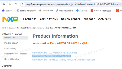

      When I configured devkit-mpc5748g using EB tresos27.1.0, MCAL, The corresponding MCAL links to  “https://nxp.flexnetoperations.com/control/frse/product?entitlementId=594560027&lineNum=1&authContact...
