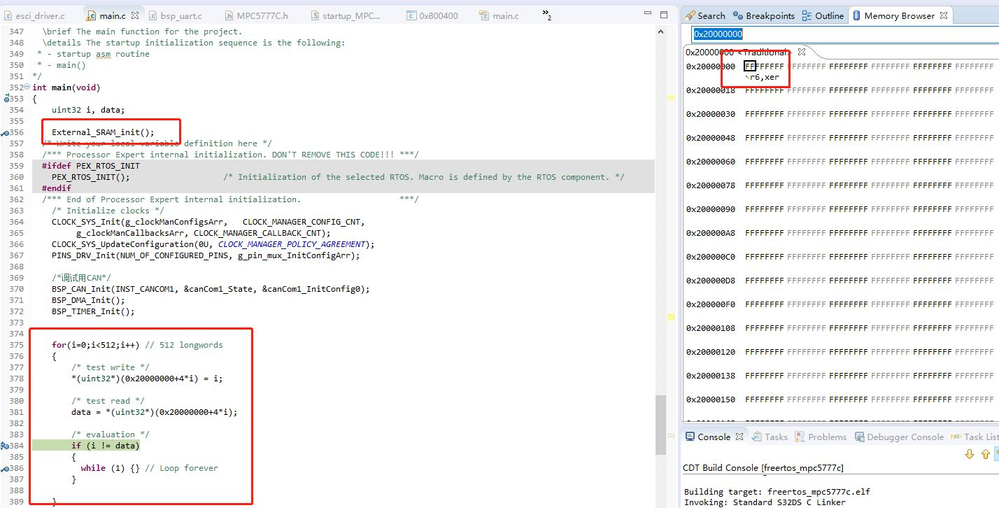

1620773328
Hi David,
Thanks for your reply.
I tried to port the example you mentioned to s32,It does not work as expected.
IDE : S32DS for Power Architecture
OS : windows10
Project : freertos_mpc5777c example  project in S32SDK for Power Architecture
My steps as flow:
1. Change J4 to choose CS0
2. Config MMU Registers in file startup_MPC5777C.s
3.  Modify SRAM Init function
4. Run to check

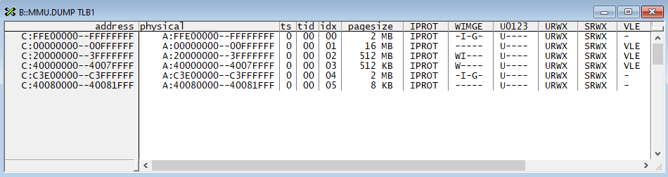

davidtosenovjan
Could you show me MMU table sccrenshot as follows?

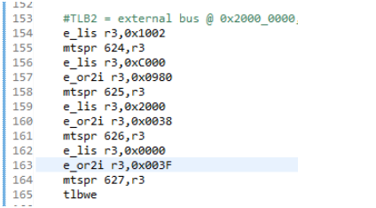

I don't know where i can find this tool. I am sorry.I only have startup_MPC5777C.S file.
MMU configuration shows blow:

#TLB2 = external bus @ 0x2000_0000, VLE
e_lis r3,0x1002
mtspr 624,r3
e_lis r3,0xC000
e_or2i r3,0x0980
mtspr 625,r3
e_lis r3,0x2000
e_or2i r3,0x0038
mtspr 626,r3
e_lis r3,0x0000
e_or2i r3,0x003F
mtspr 627,r3
tlbwe

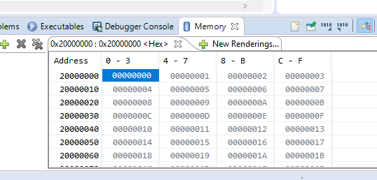

1620773328
Problem solved. Thanks very much!!

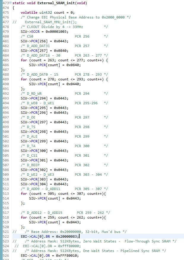

davidtosenovjan
Unfortunately not. But it should not be difficult to port it as the whole setting in located in main.c file.
