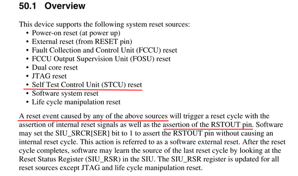

Hi Folks,
After an STCU reset, RSTOUT pin is asserted.
Is there a way to mute this pin upon an STCU reset ?
Best Regards
Omar
1,375 Views
ORaissouni
Thank you Peter for the quick answer.
1,391 Views
petervlna
No, you cannot control this pin. The device will perform the reset and signal it out via RSTOUT.
Peter
