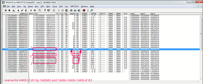

letuanvu
Hi Petervlna,
Is it possible to overwrite 1 entry by others entries with some overlaps
460 Views

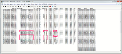

letuanvu
Sorry Petervlna, pls ignore my previous comment, the picture was not the correct one. pls checkout the below one
Is it possible to partially overwrite 1 entry (e.g 64KB) by 4 others entries ( 16KB each) with different properties
e.g: like this
First:
0x40060000 -> 0x4006FFFF - 64KB - Cache_Inhibit
Then:
0x40060000 -> 0x40064000 - 16KB - Cachable
0x40064000 -> 0x40068000 - 16KB - Cache_Inhibit
0x40068000 -> 0x4006C000 - 16KB - Cache_Inhibit
0x4006C000 -> 0x4006FFFF - 16KB - Cache_Inhibit
Thank you
