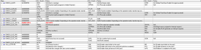

Hi, I am configuring GPIO195 Emois16 as Emois IPWM channel.
Emois16 is confugred as emois0_16,and its CNT register has values while its A and B register has no change.
Here is values of registers about the channel.
The input has been detected on hardware.Why its S16.FLAG isn't set?

PetrS
you need to enable IGF filter as well. IGF module is placed between MCU pad and eMIOS input. Emios_0 ch16 is mapped to IGF_0 ch22 so set IGF0.MCR22[FGEN] bit.

Yumimi
after configuring IGF module,A and B registers have values.Whlie I use EB25.1.1 MCAL configure ICU channel iCUSignalMeasurement mode as ICU_CUTY_CYCLE,I get the duty time.How to get the duty and period time together?
