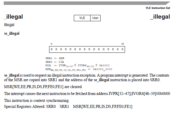

gvictorio
Hello Jongmin,
Have you tried the instruction se_illegal? that seems to be exactly what you need for the illegal instruction exception.se_illegal.PNG

jongminna
Thank you for your answer.
I have solved this question.
First of all, For the illigal insturction error, I try to execute instruction at the unused area.. Then exception error is arised.
Cache parity error is arised by cache controller, cache error injection.
Is it right solution?

lukaszadrapa
when you access memory (either instruction fetch or data load/store) and bus error occurs (unimplemented memory, ECC error...) then IVOR1 is triggered regardless of MSR[ME].
Read the chapter "7.6.2 Machine Check Interrupt (IVOR1)" in core reference manual for more details:
http://www.nxp.com/files/32bit/doc/ref_manual/e200z760RM.pdf
If a bus error does not occur during instruction fetch but invalid opcode is loaded (or se_illegal is used) then IVOR6 is triggered.
Yes, it is possible to inject the error to cache:
Cache errors will trigger IVOR1 exception. See the tables:
Table 7-10. Error Report Machine Check Exceptions
Table 7-11. Asynchronous Machine Check Exceptions
... in core reference manual.
