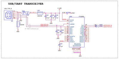

Thank you for your response. I was in fact able to verify that I have forced serial boot using the method you mentioned with the debugger. I am still having issues though communicating via UART. I believe I have configured everything right and have set the baud rate to 48000. I am connected to the SCI RX and TX pins located on Port D of User Connectors. When attempting to send over the 64-bit password (FEED - FACE - CAFE - BEEF) I am still receiving random characters back. Is there something more I need to do? I included some pictures as to what I am seeing on my side.

lukaszadrapa
Hi Karl,
you are connected to TXDC/RXDC, not to TXDA/RXDA.
TXDA/RXDA (balls M2 and M3 on 416pin package) are connected only to USB/UART transceiver:
These pins are not available on pin headers on the motherboard.
