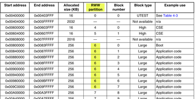

lukaszadrapa
Hi @latheef
are interrupts disabled? The erase/program functions are launched from RAM in the drivers but if there's an interrupt accessing the flash, it can fail.
Your bootloader and start of your application are all in partition 6, so I guess this is Read-While-Write problem.
So, as a first step, I would like to disabled interrupts.
Lukas

latheef
@lukaszadrapaI checked the flash  driver code and it is not coded to be executed from the RAM. When run in Debug Ram mode it all work well.
I could see there is section .code_ram in the linker script, but not used.
I have to erase 15 App sectors and each erase takes 1 second each, but I need to handle the UDS session and send the can message in between to make the UDS tool happy. Do I need to load all the code (including the S32DS CAN Driver code ) to RAM when erasing/programming is going on? If so how do I do it?
