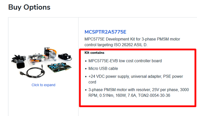

Dear Mr./Mrs,
Does MPC5775E 3-phase PMSM Development Kit contain debugger for development? Or Should we buy debugger such as PEMicro. We are waiting for your support.
Best Regards.

As the order info express, there is no JTAG debugger included:
Peter

A PEMicro debugger could be helpful but you could also use the onboard debugger, which is a K20 chip with OpenSDA debugger and bootloader installed already. I will add that the debugger app and bootloader pre-loaded to it are up-to-date as of now. So you just need a micro USB cable and the PEmicro drivers that get installed automatically with S32 2017.R1. I recommend doing an update after installation.
