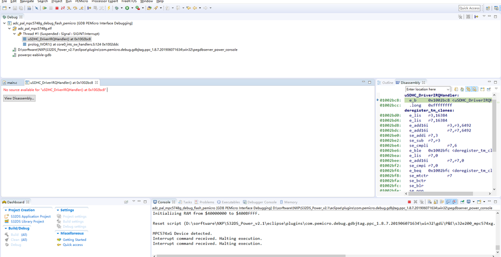

Why does "No source available for" uSDHC_DriverIRQHandler () at 0x1002bc8 "appear during debugging

dsytj88
hi Peter
I have the same problem,basing on the example of freeRTOS(SDK 3.0) for MPC5748G,I add some functions
for CAN bus.
1,the compiling is success;
2,elf file is generated;
3,in debug mode, after initializing clock,flexcan,then I want to install one callback function for FlexCAN,
after entering into FLEXCAN_DRV_InstallEventCallback,at the end of this function,some error happened.
void FLEXCAN_DRV_InstallEventCallback(uint8_t instance,
                                      flexcan_callback_t callback,
                                      void *callbackParam)
    DEV_ASSERT(instance < CAN_INSTANCE_COUNT);
    flexcan_state_t * state = g_flexcanStatePtr[instance];
    state->callback = callback;
 state->callbackParam = callbackParam;
the error is "No source available for "uSDHC_DriverIRQHandler() at 0x1002bc8" ", do you have any sollution?

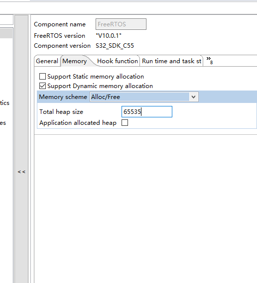

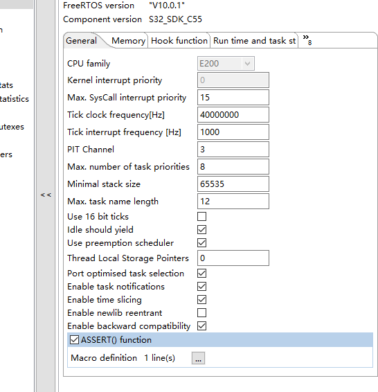

dsytj88
increase the heap/stack size.

I modified these two places and found it still not working.微信截图_20200512145122.png微信截图_20200512145113.png
