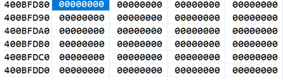

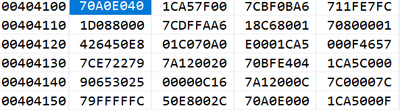

So I Dumped the memory of that address
0040_4100 ~ 0040_57D0 is reserved space in memory map.
So I guess this dumped contents is generated by internally
for boot process. Is my thought correct?
But 400b_fd80 is SRAM region.
I have no idea for this..

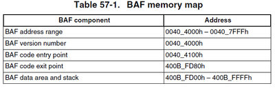

But, what is code exit point in it..?
it says code exit point is 400B_FD80.
But as you can see in my dump, the last point of BAF code is 0x0040_57D0.
And 400B_FD80 is SRAM region.
It means if NXP programmed something in here, It can't be reserved (SRAM is volatile).
1. Is my understanding about 'BAF code entry point' is correct?
BAF entry point is 0040_4100 as you can see after destructive reset.
2. Please explain more about 'BAF code exit point'

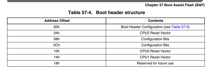

once BAF finish execution the device will boot at the address specified by user in boot header.
please refer to the reference manual :
57.1.3 Search boot header and boot options

"The BAF is programmed in NXP factory, and as I know for this device is OTP in latest cut."
The Dump memory : 0x0040_4100 ~ 0x0040_57D0 => This contents are Programmed in NXP factory.
=> this contents are maybe boot code or something for boot.
So In RM(page 2839), it says 0040_4100 is BAF code entry point.
