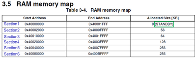

Hello
I have question in MPC5748G RM Page129
and I need to solve this question for my task..
1. What does the STANDBY mean?
2. According to that table, RAM memory has 6 Section. Why are they separate?
3. I guess that Section1 is for RAM Vector Table and Section 2 is for customSectionBlock
  But I have no idea about Section3-6.
(I refered the linker flash.ld file)
Is my guess correct? I need to make it sure.
Any help please
Best Regards
Phillip
1,964 Views
petervlna
Standy RAM is part of RAM which remains powered in low power modes. So you can use it for operation with minimum consumption.
RAM is not divided for any purpose. You can use it as you want.
