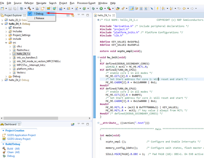

junehsiao
Hi Peter,

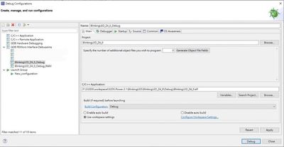

The following attachment is my BlinkingLED code.
I followed the steps from this link:
https://community.nxp.com/t5/S32-Design-Studio-Knowledge-Base/HOWTO-Create-a-Blinking-LED-Project-MP...
The only change is that in step 30, I select "Debug" in build code rather than "Debug_RAM".
And as for the Debug Configuration, the below picture is my configuration.
346114550_1223887308266016_2489130697643259255_n.jpg346114550_1223887308266016_2489130697643259255_n.jpg
Then, after pressing debug, the LED blinked successfully.
However, after a power reset, the LED stopped blinking.
Do you know what the problem might be?

petervlna
I just loaded your project.
Your code is still RAM target:
In other words, your code is in RAM. So if you reset the device RAM content is lost.
Your flash is empty:
When you creating a project make sure your target is Flash.

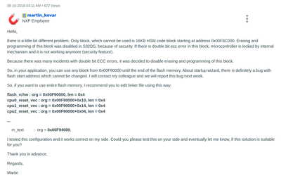

junehsiao
Hi Peter,
After looking at this link:
https://community.nxp.com/t5/MPC5xxx/MPC5748G-flash-start-address-flashStart-1000000/m-p/821300/thre...
I modified linker_flash.ld to :
MEMORY {
flash_rchw : org = 0x00F90000, len = 0x4
cpu0_reset_vec : org = 0x00F90000+0x10, len = 0x4
cpu1_reset_vec : org = 0x00F90000+0x14, len = 0x4
cpu2_reset_vec : org = 0x00F90000+0x04, len = 0x4
m_text : org = 0x00F94000, len = FLASH_SIZE
m_data : org = SRAM_BASE_ADDR, len = SRAM_SIZE
The MPC5748G's NVM memory map is attached.
After burn code, the memory is:
Which seems like it has successfully burn into FLASH.
But after power reset, LED is still not blinking.
June

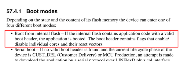

petervlna
This is unknown to me.
What you need to do is to set correctly CPU reset vector to point to your startup code.
So make sure you have valid RCHW and CPU0 reset vector points your startup code.
Thats all needed for correct boot from flash.
Once you see your device after reset jump from BAF to the address in CPU0 reset vector, you are set up and you can execute your code from that address.
Peter

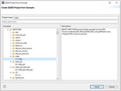

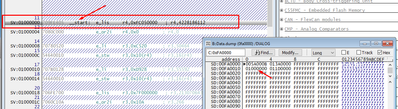

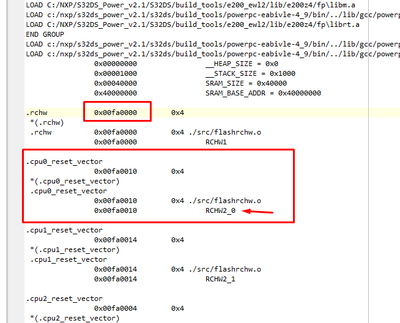

Ok, I have created simple example from S32DS examples:
By default it is set to build from flash.
So when I compile the project I can see the boot addresses:
After I burn it to the micro, I can see the RCHW is valid and it is on the place it should be (in flash).
Everything is just working with default settings.
I have attached for you the project as well.
Simply load the elf to the device and you are done.
Peter
9,800 Views
junehsiao
Hi Peter,
I followed your instructions, and got the same result as you did.
349079149_564090649233293_2941788569189195415_n.png349079149_564090649233293_2941788569189195415_n.png
346168843_907825633661118_1129064753643655560_n.png346168843_907825633661118_1129064753643655560_n.png
After burn code and run code, one LED light up (which is correct).
But after a power reset (switch SW2 off then on), the LED light disappear.
Can your board still runs the code after a power reset? I would like to ask what board did you use.

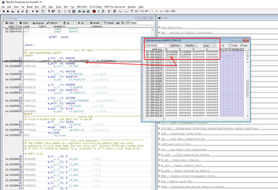

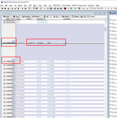

petervlna
Just tested your code for z4_1. It boot correctly from address 0x0100 0000.
After power on reset or any kind of reset.
If any LED you have in code works, I do not know as I use X-MPC574XG EVB board.
This is an application issue rather the micro one.
What comes to my mind is that you have some remnants of code in your micro, like previous Boot address on address lower then 0xFA0000. Check the micro for these addresses.
Check also there is your start address after power on reset. If the micro jumps to 0x0100 0000 address like I see in your code tests here:
Peter

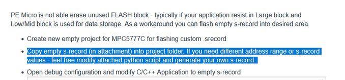

9,648 Views
petervlna
Do you know how to earse previous Boot address on address lower then 0xFA0000?
Yes. You can for example use nexusPPC from PEMicro web pages.
Or you can use S32DS to load empty binary to device:
https://community.nxp.com/t5/S32-Design-Studio-Knowledge-Base/HOWTO-MPC5777C-Low-Mid-Flash-block-era...
But first check if there are any RCHW on bootable addresses. If there are none, then it makes no sense to erase it.
You must be able to see where the code boots. I can see your code here on my sample boots at 0x0100 000 address. Do you see the same?
Peter

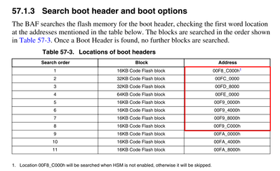

junehsiao
Hi Peter,

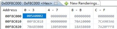

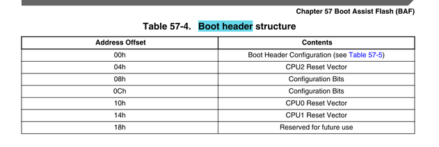

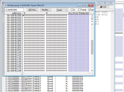

From your reply, does RCHW mean 005Ah in the first halfword?
In my case, my target boot header is FA0000h but I also got a 005Ah in F8C000h.
Screenshot from 2023-05-30 15-02-40.pngScreenshot from 2023-05-30 15-02-40.png
So that's why I wanted to ask how to erase the incorrect boot header in F8C000h.
Also, in your reply, the link is for MPC5777C,  do you have the mpc5777c_low_mid_empty.srec file for MPC5748G?
June
9,612 Views
petervlna
Yes. So your issue is that you do not erase whole flash, and the remnants of previous boot header are still there.
No, I don;t. you have to create it by yourself. Simple create empty s-record with any tool you like.
But, I expect for you would be much easier just to use nexusPPC SW from PEMicro, where erase of flash is available directly.
