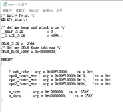

https://community.nxp.com/t5/MPC5xxx/MPC5748G-flash-start-address-flashStart-1000000/m-p/821300/thre...
I modified linker_flash.ld to :
MEMORY {
flash_rchw : org = 0x00F90000, len = 0x4
cpu0_reset_vec : org = 0x00F90000+0x10, len = 0x4
cpu1_reset_vec : org = 0x00F90000+0x14, len = 0x4
cpu2_reset_vec : org = 0x00F90000+0x04, len = 0x4
m_text : org = 0x00F94000, len = FLASH_SIZE

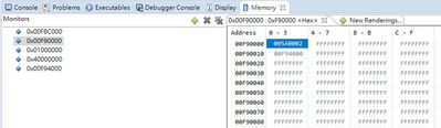

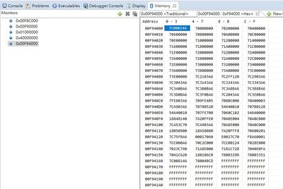

m_data : org = SRAM_BASE_ADDR, len = SRAM_SIZE
The MPC5748G's NVM memory map is attached.
After burn code, the memory is:
Which seems like it has successfully burn into FLASH.
But after power reset, LED is still not blinking.
June
9,959件の閲覧回数
petervlna
Well, I do see some data in your flash, however those are not a valid RCHW.

Dear Peter,
The board I bought is NXP MPC5748G-LCEVB (https://www.nxp.com/design/development-boards/automotive-development-platforms/mpc57xx-mcu-platforms...).
And my development tool is S32DS for Power Architecture IDE(https://www.nxp.com/design/software/development-software/s32-design-studio-ide/s32-design-studio-for... ) that NXP suggested to use.
I ran the hello world example project from S32DS SDK, but after many tries, still couldn’t burn FLASH code to the board.
I would like to ask if you can give a simple sample project that can correctly burn FLASH code to MPC5748G-LCEVB?
Thanks.
BRs,
June
9,845件の閲覧回数
petervlna
Ok, I have created simple example from S32DS examples:
By default it is set to build from flash.
So when I compile the project I can see the boot addresses:
After I burn it to the micro, I can see the RCHW is valid and it is on the place it should be (in flash).
Everything is just working with default settings.
I have attached for you the project as well.
Simply load the elf to the device and you are done.
Peter

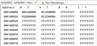

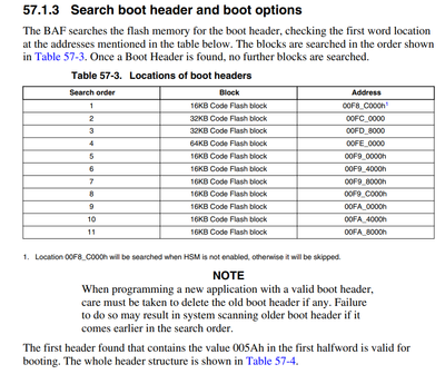

junehsiao
Hi Peter,
From your reply, does RCHW mean 005Ah in the first halfword?
In my case, my target boot header is FA0000h but I also got a 005Ah in F8C000h.
Screenshot from 2023-05-30 15-02-40.pngScreenshot from 2023-05-30 15-02-40.png
So that's why I wanted to ask how to erase the incorrect boot header in F8C000h.
Also, in your reply, the link is for MPC5777C,  do you have the mpc5777c_low_mid_empty.srec file for MPC5748G?
June
9,607件の閲覧回数
petervlna
Yes. So your issue is that you do not erase whole flash, and the remnants of previous boot header are still there.
