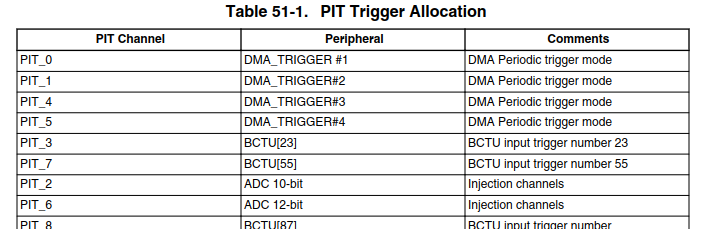

I'm working on ADC module in MPC5748G and want to use an external trigger to start ADC injected conversion.
I'm using  MPC5748GRM Rev. 6, 10/2017, at https://www.nxp.com/docs/en/reference-manual/MPC5748GRM.pdf
And It describes at  32.6.1.3.1 Starting injected conversion
To start an injected conversion via external trigger, enable external triggering by setting MCR[JTRGEN]=1. A programmed event (rising/falling edge depending on MCR[JEDGE] bit) on the injection trigger input starts the injected conversion
But I can't find the external trigger source to generate trigger source.
Please help to figure out the external trigger source for ADC injected conversion.

PIT channels 2 and 6 are used as external trigger for injected conversion, see table 51-1 PIT Trigger Allocation

Thank Petr,
It's hard to read the information in the RM when not work with PIT module.
I think the RM should descripbe it in the ADC chapter, same the other RM like MPC5744P. It has a timer interface in ADC configuration section.
