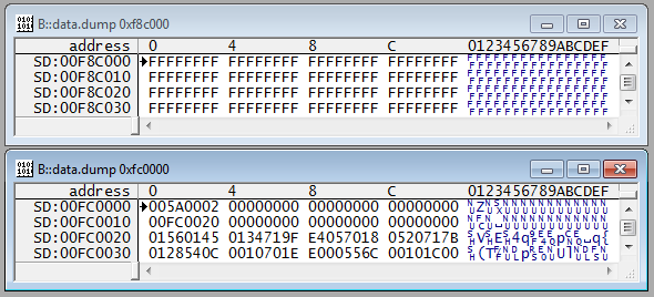

lukaszadrapa
I did quick test and it works as expected on my side. I just modified my old sample project like this:
That's the only modification because boot_header is placed at the beginning of this segment.
And I confirmed in debugger that the boot header is really placed at 0x00FC_0000:
It works in debug mode and it also works in standalone mode. Could you try it? Project is attached.
Lukas
