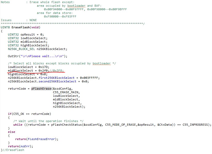

And there are my code:

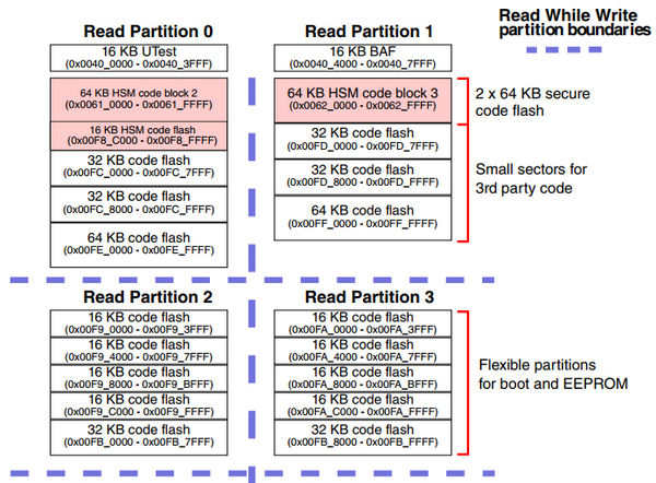

when midBlockSelect = 0x2f0, pFlashErase() worked well, but if midBlockSelect = 0x3F8, it jumped to IVOR1. When midBlockSelect = 0x3F8, blocks 0x00F90000--0x00F93FFF and  0x00FB0000--0x00FB7FFF are selected to be erased, but they are located in Read Parition 2 which contains my bootloader codes. That might cause the IVOR1Trap, but I'm not so sure about it.

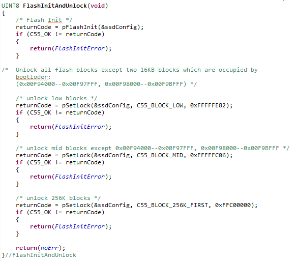

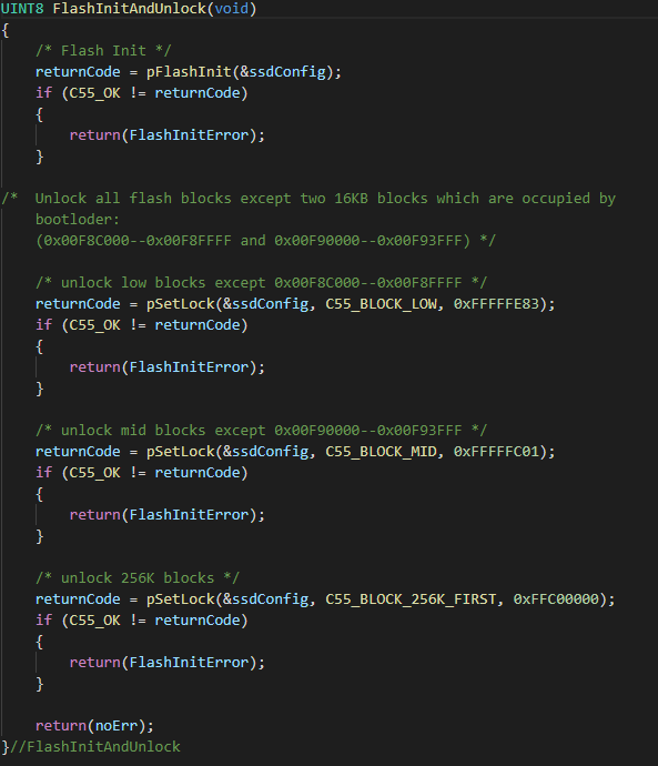

And there are codes from AN5319:
When lowBlockSelect = 0x17C, it will erase blocks  0x00FC0000--0x00FC7FFF,  0x00FC8000--0x00FCFFFF and  0x00FE0000--0x00FEFFFF in Read Partition 0 which contains block  0x00FC8000--0x00FCFFFF occupied by bootloader.
When midBlockSelect = 0x3FE, it will erase several blocks in Read Partition 2 which contains block 0x00F90000--0x00F93FFF  occupied by bootloader.
So what's the real reason, please help me to find it, thanks! And forgive my poor English ^_^.

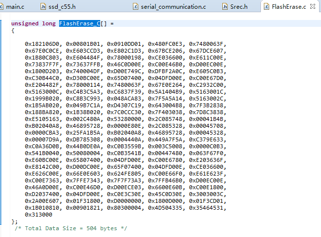

I wrote in section 4.2 Flash programming in the application note:
"Used C-array drivers are defined as constants by default. C-array drivers are compiled as position independent and they can be copied to any location. We can either copy the drivers to RAM manually or we can simply re-define them as variables (just delete “const”) and they will be automatically copied to RAM by startup code."
If you open the c-array files which modify the flash, you will see:
Lukas

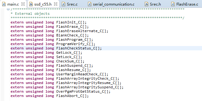

Hi Lukas,
Actually I deleted all "const" in C-array drivers before I wrote my question in here, there are some codes:
And according to your application note:
I didn't move these functions and resources to RAM, so that should be the reason.
But next question is: How to move these functions and resources to RAM in S32DS?

lukaszadrapa
when you delete the "const", the arrays are going to be initialized variables, so they are automatically copied to RAM memory by startup files. When you reach the main function, you can check that it is already copied. You can find the addresses in map file.
