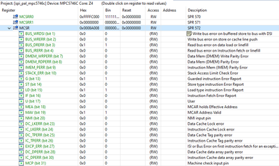

Greetings!
I am using the MPC5746C on a custom PCB with PEmicro Debugger. I am attempting to run an example SPI program provided by NXP, located at C:\NXP\S32DS_Power_v2.1\S32DS\software\S32_SDK_S32PA_RTM_3.0.0\examples\MPC5746C\driver_examples\communication\spi_pal inside my local file system.
The pin assignments/connections on my custom board are inspired from the MPC5748G-LCEVB evaluation kit, but not exact. Hence, I changed the pin_mux and spi1/2 component configurations to be aligned with what our board supports and generated the Processor Expert code. The program builds.
I also followed the instructions at the following webpage and modified the physical connections to align with our board: S32 SDK: SPI PAL MPC5746C
When I run the program, inside main() the code calls SPI_MasterInit():
Inside SPI_MasterInit() the code calls DSPI_MasterInit():
Inside DSPI_MasterInit() the code calls DSPI_Set_MCR_Halt():
Finally, inside DSPI_Set_MCR_Halt(), when the program attempts to execute the first line inside the function, a Machine Check Interrupt (IVOR1) is raised.
At this point the execution is paused in an infinite loop.
The cause of this issue is puzzling and my efforts to track it down have been unsuccessful. Is there any guidance that you can offer me to assist me solving this issue?
When I run the equivalent example on the MPC5748G-LCEVB, it works fine.
If it's helpful, here is what my MCSR register looks like:

davidtosenovjan
If I run this code on my board it goes to IVOR1 as well because ADC registers are not available because Mode Entry transition didn't happen and device is not clocked according the setting.
Pay attention to Mode Entry module.

davidtosenovjan
Could you screenshot also MCAR register?
Interesting value is stored in MCSRR0 register as it should be address of instruction causing an IVOR1 exception (machine check) and you have 0xFFFF_C000 what's reserved region within PBRIDGE_A memory space.
6,011件の閲覧回数
pstammii
Hi David,
I ran the program again and realized that in the original screenshot I didn't capture the MCSRR0 register at the moment the exception is raised. Here is an updated screenshot taken at the proper time and including the MCAR register you requested. Thank you.
