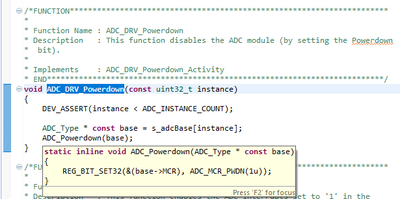

I am not sure what is going on but I have tried running multiple NXP example projects using the built-in function from the processor expert, and among all of them what I am seeing in common is when a function tries to access a module register (like MCR) it triggers the IVOR1 exception handler and won't return to finish executing the rest of the code. Here's an example function:
When the controller tries to execute the REG_BIT_SET32(&(base->MCR), ADC_MCR_PWDN(1u));, this is where the IVOR1 is raised and it won't execute.

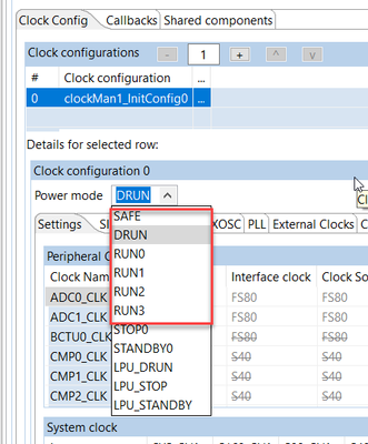

Follow-up question:
Instead of manually coding the Mode Entry module, can I just use the clock_manager component in Processor Expert? Isn't that the point of it, to do the Mode Entry leg-work? Or no?
Thanks.
Paul
5,664件の閲覧回数
davidtosenovjan
Yes, the component configures ME setup, so it is it properly configured, it could be enough.
5,656件の閲覧回数
pstammii
Thanks David.
The issue was incorrectly configured clocks, which was not allowing the mode entry sequence to complete. Once I got that right I ended up just using the clock_manager inside Processor Expert to configure everything and initialized by calling the two functions below, which I learned about through some of the examples in the S32 SDK (the functions are in clock_MPC57xx.c). Just using the CLOCK_DRV_Init() processor expert function was not enough.

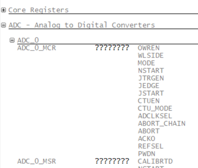

  • The ADC1 MCR/MSR registers continue to show a value of 0x0 (I am not aiming to use ADC0, just FYI)

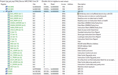

Could you screenshot also MCAR register?
Interesting value is stored in MCSRR0 register as it should be address of instruction causing an IVOR1 exception (machine check) and you have 0xFFFF_C000 what's reserved region within PBRIDGE_A memory space.
5,919件の閲覧回数
pstammii
Hi David,
I ran the program again and realized that in the original screenshot I didn't capture the MCSRR0 register at the moment the exception is raised. Here is an updated screenshot taken at the proper time and including the MCAR register you requested. Thank you.
