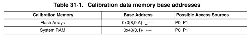

lukaszadrapa
this is copied from reference manual:
That means you can use any address within RAM implemented on this device (0x40000000 -- 0x4005FFFF).
Lukas

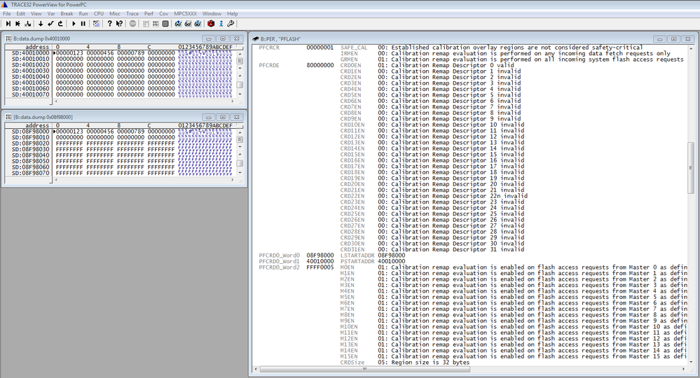

lukaszadrapa
I did quick test in debugger:
I configured descriptor 0 to overlay 32 bytes of flash at address 0x08F98000 by RAM at 0x40010000. When I enable the descriptor, I can see the RAM content at flash address:
If I disable the overlay, I can see original content (all 0xFF) at 0x08F98000:
Please check my configuration.
By the way, this piece of code:
C55FMC.MCR.B.PGM = 1;
    *(unsigned int *)Small_Flash_Memory_Block_0_BEGIN = 0xffffffff;
    C55FMC.MCR.B.PGM = 0;
... doesn't make sense. When you enable the overlay, it does not copy any data. It just re-map the RAM, so you see the RAM at flash addresses. If you want to see the flash again at the same addresses, you have to disable the overlay.
Lukas

ivanmandic
Hello again,
I looked at your configuration and saw that i haven't set M0EN as  '1'. That basically fixed my problem. The part of the code that doesn't make sense is used for safety measurement if there will be the use of line read buffer.
Thanks for the help again.
