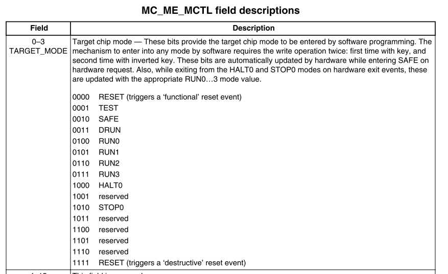

Just call mode transition to reset mode:
//Mode transition to apply the PLL0 setup and set Normal mode with PLL running
    MC_ME.MCTL.R = 0x00005AF0;              //Funtional reset  Mode & Key
    MC_ME.MCTL.R = 0x0000A50F;              //Funtional reset Mode & Key
Peter

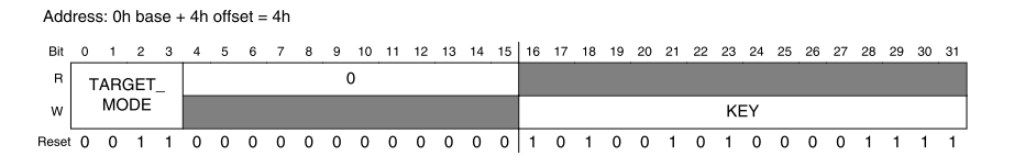

Hi,Peter
   Can I just switch the operating mode without resetting?
   Since I want to jump from the boot application to the application, the application again configures the run mode with the clock.

petervlna
Yes you can do mode transition into any mode you like, reset is just one of the available mode options.
as it is described in reference manual.
