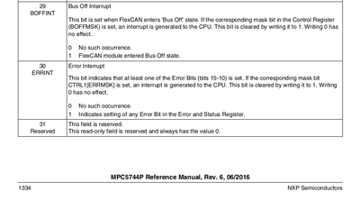

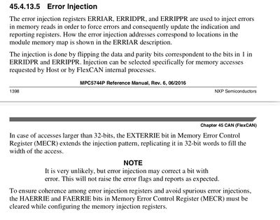

I want to error injection for CAN module for integration test. I configure CAN as loopback mode. I use lauterbach for debugging. I have a following CAN configs:
There is contains informations about error injection in datasheet:
I want to inject error for ERRINT from ErrorStatusRegister1. ERRINT register is interrupt flag:
I try to error injection after enter freeze mode following codes:
