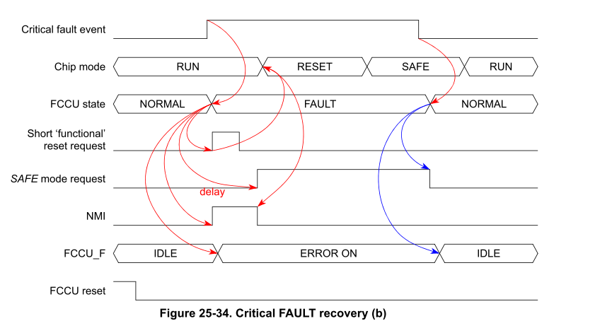

petervlna
In Reference manual : Chapter FCCU-> Functional description -> Fault recovery is described how to recover from critical fault:
NMI is asserted whenever the FCCU detects critical fault. As the picture above represents. NMI is released when micro enters RESET state.
NMI is for z7 core handled via IVOR1 (Machine check).
For more details about NMI refer to Reference manual -> 54.4.2 Non-Maskable Interrupts (NMI)
Peter

petervlna
The NMI is triggered before Reset and/or Safe mode. Like the figure 25-34 Critical fault recovery represents.
Safe mode after critical fault is entered directly from reset mode.
When FCCU detects the critical fault it is going immediately to FAULT state like it is described in this figure.
Read your FCCU faults in NMI interrupt.
Hint: minimize the code to find easier the source of reset.
Peter

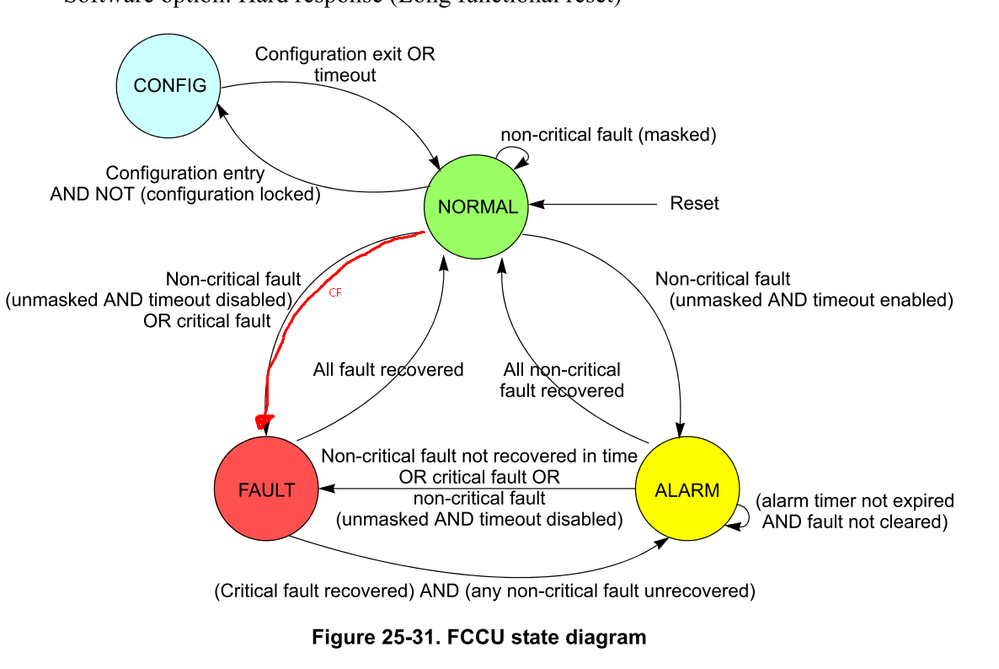

petervlna
From your FES content I can see that the reset was caused by FCCU HARD reaction.
FCCU also forced micro into SAFE mode.
To find the root cause of your issue you need to read FCCU CF and NCF status registers. (FCCU_CFSn / FCCU_NCFS0).
For more details refer to FCCU chapter in reference manual.
Peter

petervlna
You are getting FCCU CF and NCF registers values after destructive reset. The FCCU content is destroyed by destructive reset.
This is the reason why you see zero values in status registers.
FCCU implements alarm state in its state machine.
If you was to store the FCCU registers value before the reset use the ALARM state.
FCCU can be configured to react on fault by moving into ALARM state. (Device is still not reset)
The Fault source is stored in FCCU fault status registers.
During alarm store the FCCU status registers to memory which is not affected by destructive reset. Flash, etc...
When ALARM timeout expires then reset is performed.
After reset you can read original content of FCCU status registers as it is stored in Flash, EEPROM, etc...
But to simplify root cause finding you can explain me what you are doing before/when micro resets.
Are you using some specific peripherals?
Peter

petervlna
In your ISR are you reading and clearing the faults?
[Now I realize that FCCU cannot react on critical faults with ALARM state on this device]
One more thing which can help:
Disable the FCCU reaction on critical faults in FCCU_CFS_CFGx registers.
Write to FCCU_CFS_CFGx registers 0x0, but it must be written trough CONFIG mode.
This will prevent FCCU reset reaction on critical fault.
However some faults are routed redundantly also to RGM and can trigger reset immediately.
Now when your critical fault comes the FCCU will store it in CFSx register and trigger SAFE mode request to Mode entry module.
The interrupt 51 is safe mode interrupt.
In this interrupt you can read FCCU CF fault status registers.
Hope this will help.
