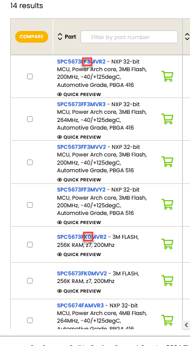

davidtosenovjan
'F3' and 'K0' are mask identifiers.
SPC5674FK0MVY3 is mask 0N31E. Your second device is mask 3M17W.
Both are equivalent and both chips are revison 2 thus included eTPU2 module.
