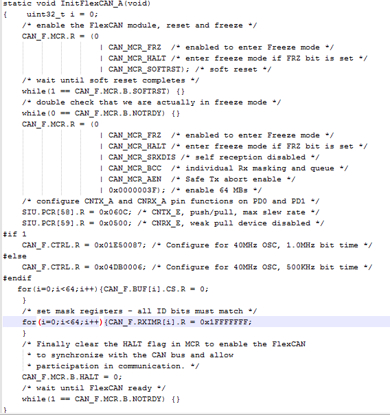

Dear Petr,
Thanks for your comments,
To provide little more information, we are trying to use CAN_F and we changed the code accordingly by referring the manual.. I am attaching the modified code as below. In the main case 0 for transmission is happening and waiting in "Poll CAN Tx flag to track successful transmission"
Kindly let us know, whether we need to change anything else.

sukruthrameshba
Dear Petr,
We are discussing with you in the NXP community discussion.
We have attached the code, where we were trying to use CAN F and standard CAN ID for transmission. We are getting stuff error and stuck in case 1 for CAN F’s Tx flag for successful transmission. we checked for Bit timing also.
Could you please check and provide quick update and it will help to proceed further.
Thanks in advance for your support
