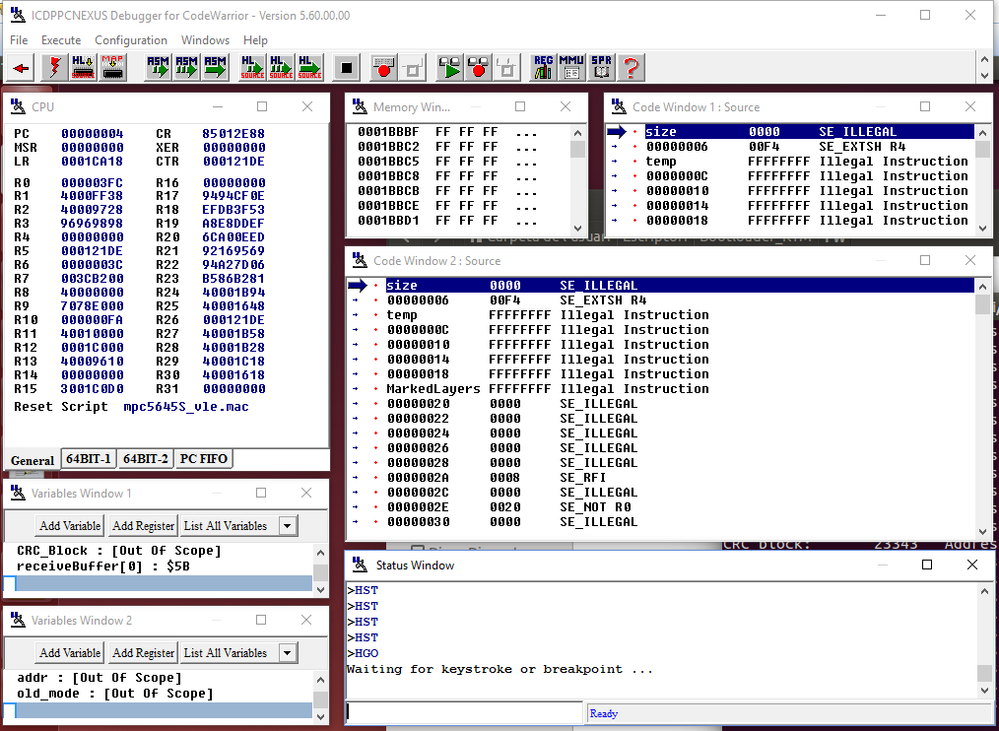

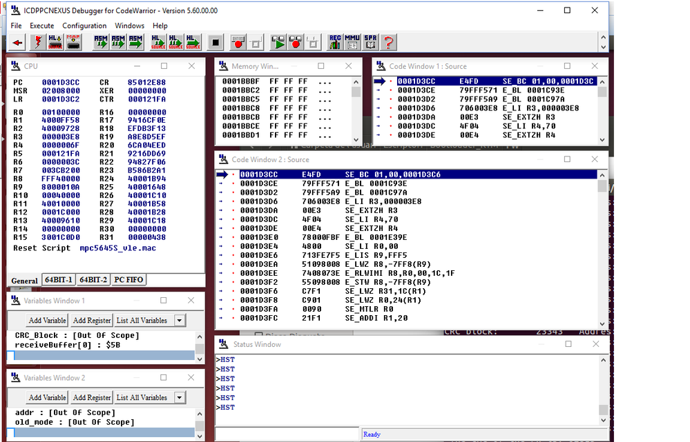

The core register values before crash are the followings:
When the program crash we can see this registers:BootloaderCrash.PNG
There are a lot of instructions that can cause the crash. All functions and buffers that are stored in "int_flash" section could cause a crash.

petervlna
Are you aware that every compiler use different #pragma definitions?
Is good to specify at least basic information about your project.
What is the last instruction before your program crash?
Check instruction and core registers to find out if you are accessing memory which can be accessed.
Peter

petervlna
Can you check core registers values (registers which are used  by last instruction) and instruction which cause crash?
This is a simple way how to find out where you are trying to access and why it crash.
Peter
