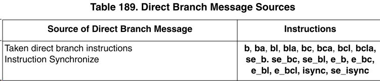

Did you tried any other type of jump instead of se_bctrl ?
You can try direct jumps:
regards,
Peter
