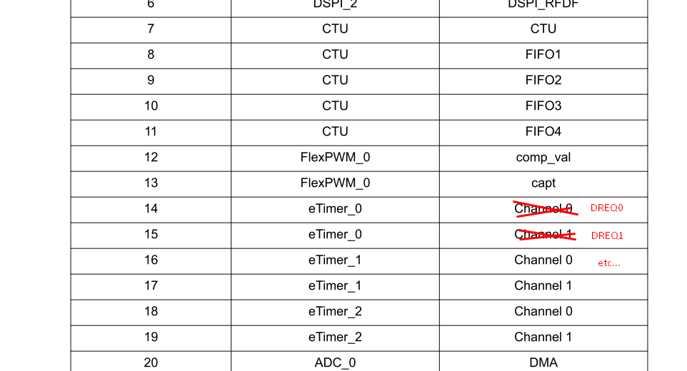

1. On eTimer CMPLD2 you want to trigger DMA transfer.
2. DMA is triggered on this event if DMA and DMAMUX is properly configured.
3. Source/Destination address of DMA can aby any valid address.
4. If you want to set CMPLD2 value by DMA then set the destination address to CMPLD2 address and source address to address containing desired value of CMPLD2.
5. You can also achieve this by SW via interrupt.
Reference manual is not correctly describing eDMAMUX.
It should be as follows.

Q2: why did the DMA_mux module have no etimer channel 2~4 DMA request source.
If etimer0 DMA request select register select channel 5 CMPLD1 DMA write request, how to configure the corresponding DMA_MUX source ?
