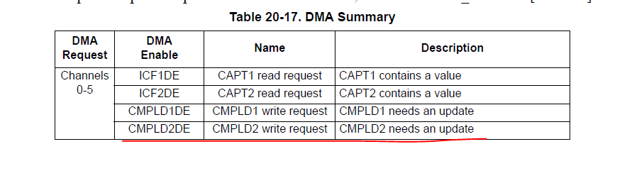

I think I have some misconception about the DMA request of the eTimer module.
Q1: I don’t know how to use the INTDMA register.
Example: if I want to use the DMA read requests for CAPT1,then I should set the .ICF1DE bit (INTDMA) .
My question is whether I need to configure the conrresponding DMA channel source , channel source address and destination addrress?
My confusion is that the ICF1DE bit which equals 1 has showed the souce address is CAPT1, does we need configure the source address again?
Did anone have conrresponding example codes ?
Thanks very much!
Yanna

Hi,Peter,could you help check the following code ?
ETIMER_0.CHANNEL[0].INTDMA.B.CMPLD2DE = 1;  //enable DMA write requests to the CMPLD2(channel 0 ,Etimer0)
ETIMER_0.DREQ0.B. DREQ0 =00011; // select channel 0 CMPLD2 DMA write requests
ETIMER_0.DREQ0.B. DREQ0_EN =1; // DMA request enable
ETIMER_0.ENBL.B.ENBL =000001; // enable channel 0
DMAMUX.CHCONFIG[0].B.TRIG = 0;
DMAMUX.CHCONFIG[0].B.SOURCE = 14;   // DMA write requests
DMAMUX.CHCONFIG[0].B.ENBL = 1;
EDMA.CHANNEL[0].TCDWORD0_.B.SADDR = &VAL_CMPLD2;   // Source Address
EDMA.CHANNEL[0].TCDWORD16_.B.DADDR =&CMPLD2;   // Destination address
(then configure smod,ssize and so on. )
I just want to emphasize destination address and principle,
My question : is destionation address in above codes right ?
Another question, could destionation address be the value which has no relation with CPMLD2 ?
Thanks very much!
Yanna

yanna
Hi,peter,  the destionation address is ETIMER_0.CMPLD2.R
   EDMA.CHANNEL[0].TCDWORD16_.B.DADDR =&ETIMER_0.CMPLD2.R;
When data is transferred out of the CMPLD2 register and ETIMER_0.CHANNEL[0].INTDMA.B.CMPLD2DE = 1 ,did the destionation address of the conrresponding DMA channel must be &ETIMER_0.CMPLD2.R ?
From your words,it seemed that it can be any valid address. P.476 It says when a CMPLD2 write request occours,it means CMPLD2 neeeds an update,so the destination address of the conrresponding DMA channel seems should be the &ETIMER_0.CMPLD2.R,is it right?  If the destination address isn’t the ETIMER_0.CMPLD2.R,how could the CMPLD2 register get the update value?

yanna
Hi,Peter. Thanks very much!  It helps me a lot.
another question,If I set Destination address of DMA the  address which has no relation with CMPLD2(CMPLD2DE = 1) ,  will the  ETIMER_0.CMPLD2.R value maintain the original value?
Thanks very much!
3,718 Views
petervlna
Yes, it will maintain the original value until it is changed via DMA or via software (core).
