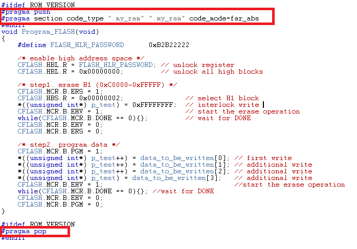

What is the meaning of the red frame, please?
1 返信
1,175件の閲覧回数
davidtosenovjan
Hi, it means that function in the screenshot is relocated to the internal SRAM and executed from that. It is being done to prevent read-while-write error.
