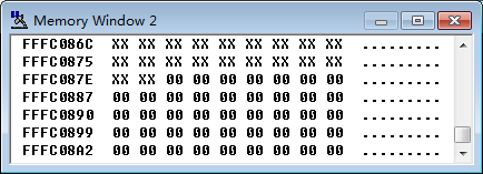

 I do that:
CAN_A.MCR.B.MBFEN =1; //Use Individual Rx Mask Register
CAN_A.RXIMR[4].B.MI = 0x00001000;
but:CAN_A.RXIMR[4].R  is Always Read 0x00000000;

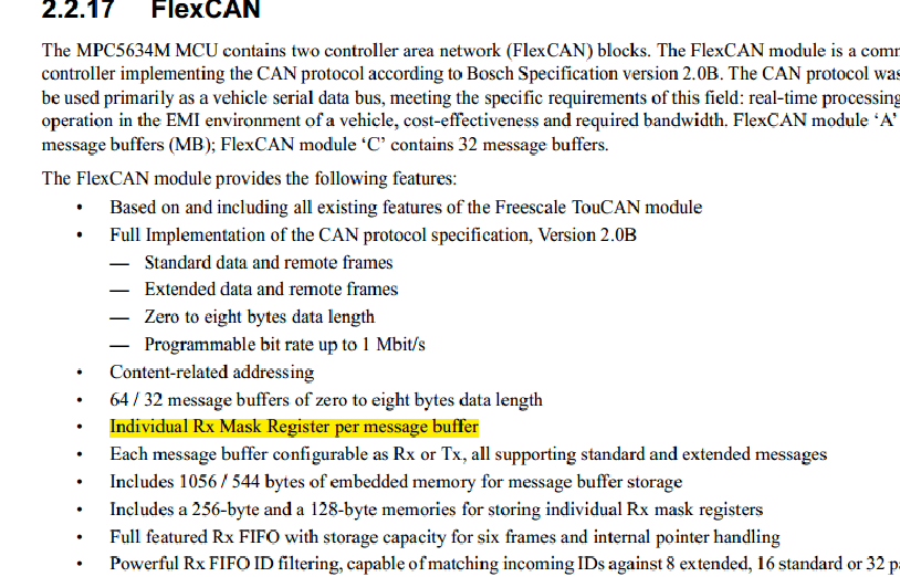

MPC5634M datasheet

The Individual Rx Mask Registers can only be accessed by the CPU while the module is in Freeze Mode and MBFEN is set. Out of Freeze Mode, write accesses are blocked and read accesses will return “all zeros”.
So be sure the FlexCAN is allowed to enter Freeze mode (MCR[FRZ] set) and Freeze mode is really entered once you break debugger (FRZACK and NOTRDY flags set).
BR, Petr
1,548件の閲覧回数
413515651
Thank you!! I solved it.
