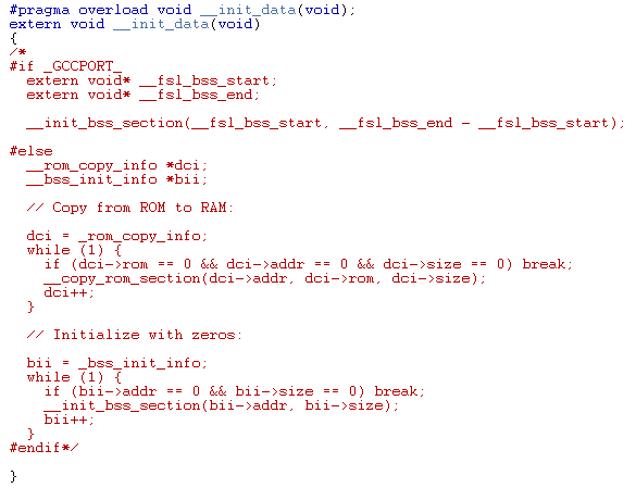

I can see you have commented out the __init_data() function:
So, global variables are not initialized - including pointers to SSD flash functions:
extern unsigned int FlashInit_C[];
extern unsigned int FlashErase_C[];
extern unsigned int BlankCheck_C[];
extern unsigned int FlashProgram_C[];
extern unsigned int ProgramVerify_C[];
extern unsigned int CheckSum_C[];
extern unsigned int GetLock_C[];
extern unsigned int SetLock_C[];
When you call the FlashInit:
returnCode = pFlashInit( &ssdConfig );
... it will crash...
Lukas

Thank you for your reply.I added your prompt code, code but I will not run through the guidance of BAM into RAM. Examples of this is my revised, and bam recorded data transmission, would you please help me, thank you!!!!!What would be the reason for this ?
6,450 Views
lukaszadrapa
I can see that the initial values of the global variables are loaded to RAM memory together with elf file. So, the initial values are already part of your binary image and there are some data at 0x40003000. This seems to be a feature of linker when creating RAM target for debugging. Function __init_data does not re-init these values (but I can see it copies some different data anyway).
So, I can see two solutions:
- initialize global variables manually at beginning of main function. In your example, initialize pointers to SSD functions and ssd_config structures. This is the easiest workaround.
- second option would be to get the last init address from linker file and initialize the RAM memory only behind this address.

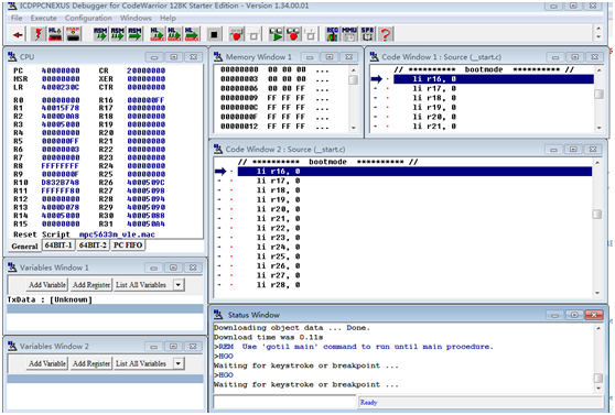

6,450 Views
wanglong
Thank you for your answer.If you open the CAN, you can download and run through BAM.
After loading the FLASH can not run, through the emulator download, found after loading
FLASH program has been at START.C Department.
