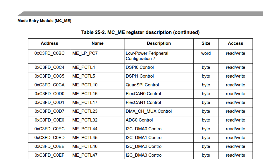

Hi all,
      I found a description of the Peripheral Control Registers (ME_PCTL0…143) in the document "MPC5606S Microcontroller - Reference Manual (REV 7).pdf".I would like to ask ME_PCTL0 to ME_PCTL143 which corresponds to the peripherals? Where can I find this information?

Hi, see screenshot below taken from mentioned RM:

hello David,
      Thank you very much for your answer to my question
