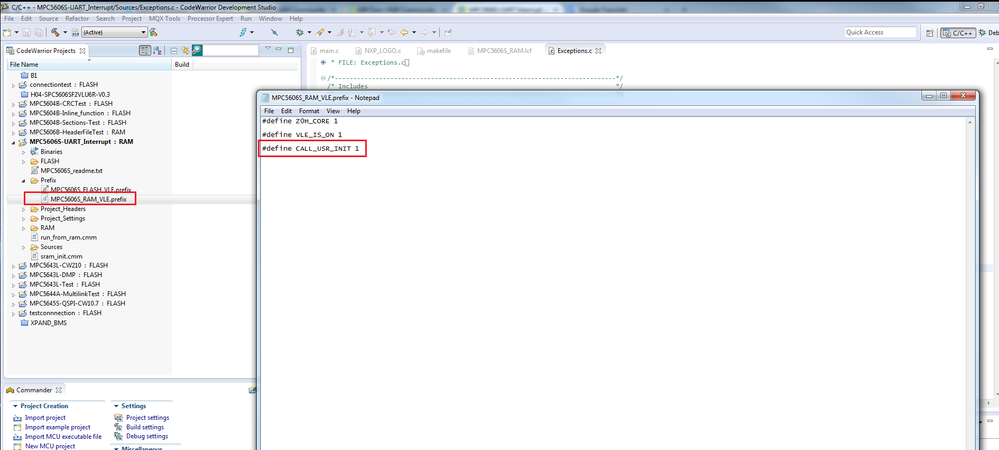

Hi all,
       I am trying to use MPC5606S UART interrupt function, but can not enter the interrupt service program.
It can not enter the interrupt function to send(  void UART1_TransmitComplete(void)) and receive(void UART1_ReceiveComplete(void)) interrupt function, attachment is my project, please help me to see where the problem?

flash target works correct. If you want to use RAM target, you have to modify RAM_VLE.prefix in your project and recompile it. Please see figure below:
Martin
3,767 Views
skysword
      Thank you for solving my problem.
Use RAM target,In accordance with your way to modify the RAM_VLE.prefix can work properly .

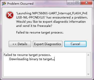

But when I use flash target to debug, the emergence of such a mistake, this is why?
Is there a problem with you?
3,767 Views
martin_kovar
this error appears only, if you use Flash target? Is it correct?
Was the code for flash target correctly compiled? Which debug probe you use? Did you try to exit CodeWarrior, start it again and connect to board? Sometimes some strange mistakes appears with PEMicro debug probe.
Please write me back as much details as possible.
Martin
3,767 Views
skysword
      Yes, when I used flash target just this error.
The code can be compiled correctly under flash target.I don't know what probe is, because I use this CodeWarrior time is not too long.I tried many times to exit CodeWarrior, and then restart the connection board, but the same phenomenon.
My IDE is codewarrior 10.7.
Microcontroller is MPC5606S.
Debugging tool is PE micro USB multilink.
  Annex is the project I use. You can give me a project, the right to use flash target debugging.
 suspect that there are errors in my engineering parameters. Thank you very much.
3,767 Views
martin_kovar
I tested your project on my side and it works correct to me. I have the same condition, CodeWarrior 10.7, USB Multilink and MPC5606S.
1) Could you please try to create new empty project, compile for Flash target and try to download into the microcontroller?
2) Try to disconnect USB cable from USB multilink, wait for a while and connect it again.
3) Also could you please check PEMicro drivers and eventually update it?
Do you get any other error than the one you posted above?
