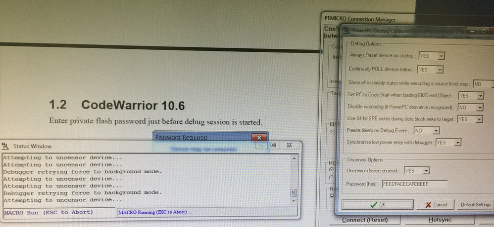

I used the code shown below the link, but after downloading it to my board, my board does not work, the LED1 is not lighting. After power-on-reset the device,I try to enable debug of censored device as decipted in attached pdf
* document,but failed.Can you tell me what I should do next

Hi, enter 0xCAFE_BEEF_FEED_FACE as described in the example description.

I have tried to enter CAFE_BEEF_FEED_FACE , but still failed.
