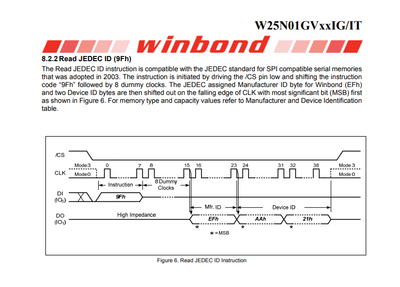

MPC5748G (Master) is communicating with NAND Flash  W25N01GV (Slave) via SPI. When ever I am sending command from MPC, nand flash is giving the correct response and it was validated by capturing the wave using oscilloscope.
The response is the correct one and signal quality was also good. MISO line shows correct data in oscilloscope, But not updated in receive buffer in the code. When checked in POPR, RXFIFO registers also, no data was present at all. What could be the reason for this?
I am attaching the waveforms from the datasheet of NAND FLASH for the command I used.

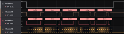

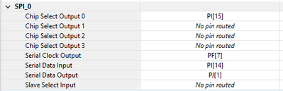

attached is modified demo code to use SPI_0 to send 5 bytes with continuous selection.
On DEVKIT board I connect SOUT to SIN to check reception on PI[14] pin.
It works well. This is what I see...
Receive buffer has the same data what is sent.
Below pins are used, so can be connected on DEVKIT easily
BR, Petr
