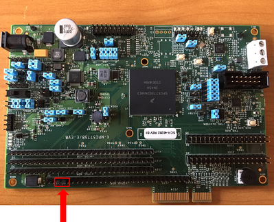

         I have a  MCSPTR2A5775E Motor development kit with a PMSM motor. The motor spun with the pre-loaded code but the communication with Freemaster interface did not work properly. Then, debugged the original example code given for the kit by NXP and the motor is not spinning now. Code debugged with default pre-defined debug configurations, using onboard OpenSDA interface. Could someone please tell me how can I solve this problem???

Can you please double-check the presence of the jumper highlighted in the picture below?
Wrong jumper position can be the reason why you can't control the machine.
Jumper configuration can by found in get starter document at NXP web page. (Get Started with the MPC5775E-EVB)
https://www.nxp.com/document/guide/get-started-with-the-mpc5775e-evb:GS-MCSPTR2A5775E
(chapter 3.4 Configure MPC5775E-EVB evaluation board )

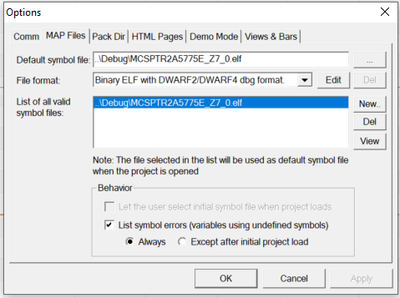

Please check also  FreeMASTER settings. Change default symbol file path to .elf file in your workspace.

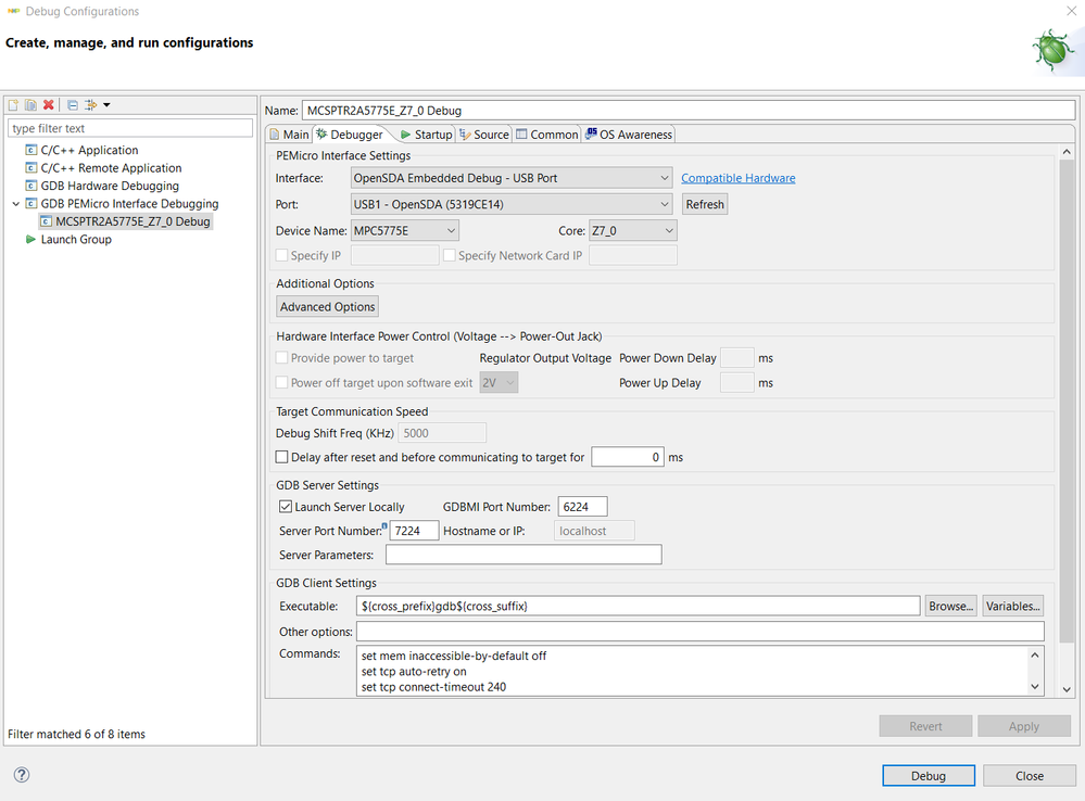

After uploading the code, board was detected by MCAT tool and this time controlling via GUI is possible. No errors or faults detected at initialization and alignment states and proceeds to the run state. But when the speed is set to spin the motor suddenly state machine goes to the fault state and the motor rotates few degrees and stops without showing any error or a fault in GUI(Phase currents, bus voltages etc.).
Reloaded the code several times and uploaded it without doing any changes.
Please have a look at the following snapshot showing debug configurations used and all are default settings.
This is the debug configurations used.This is the debug configurations used.

Gayan_Niroshana
Thank you very much @Lukas2 . The jumper was the problem. It was not there. And I could not find that in the user guide as I was focusing on the tables that describe the jumper configurations.
But I wonder, how the motor was spinning and free-master was not working at first with the factory uploaded code before I uploaded the code into the dev board.
Now every thing is working and free-master functions well.
