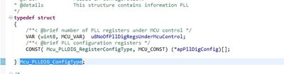

1、I encountered the following problems when using MCAL. Please help to confirm the reasons
The MC_PLLDIG_pClockConfigPB0_0 member in the generated code below has three, but the structure has only two members.  Could you please confirm the reason? Thank you
The MCAL version is MPC574XP_MCAL_4.0_RTM_HF1_2.0.2
edmundzhang760_0-1638254447307.jpegedmundzhang760_0-1638254447307.jpegedmundzhang760_1-1638254461562.jpegedmundzhang760_1-1638254461562.jpeg

As I have checked in Mcu_PLLDIG_Types.h from RTM 2.0.2 HF1, the structure contains three elements:
2. There is RTM 2.0.2 without HF, which you can download in the same place as RTM 2.0.2 HF01. The HF01 contains the fix for MCU driver, which you can find in the Release notes. Other than that, there isn't any MCAL version.
