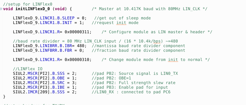

I using the MPC5748G Devkit with the OpenSDA debugger and I am having a few problems while debugging LINFlex connectivity

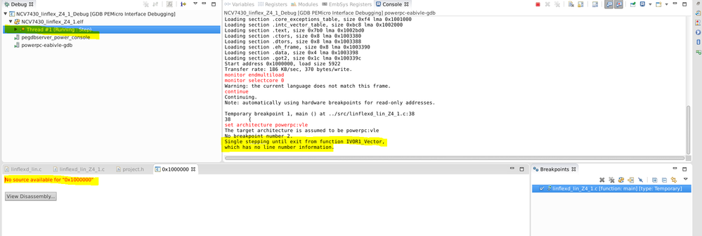

This is the code I have and when try to debug and step through this on the very first line i get the following error message:
However, if we use LINFlexD_0 instead the error is no longer there.
Can you please help us and let us what know we might be doing wrong

Do you have LINFlexD_9 clocked?
Check the ModeEntry module setting (ME_PCTL59 register).
BR, Petr
