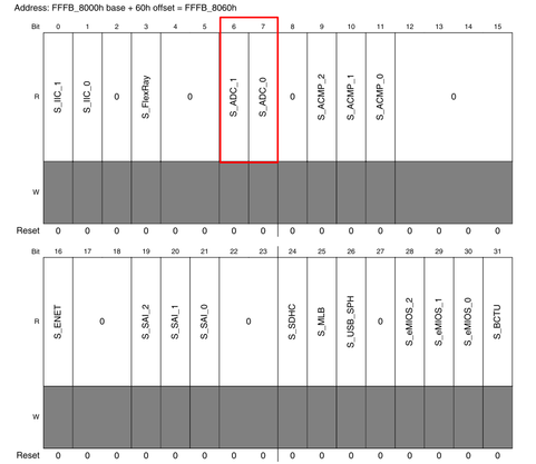

I am running into an  problem with the ADC module that I am not sure how to diagnose.
In my application, I am dropping the clock speeds down, along with turning off a lot of modules to get my current draw down to a low level. When I am trying to jump back into the regular speed, I cannot seem to write to the ADC module. I run into an IVOR1 exception. When I try to write to the ADC module with the debugger, I get a purple highlight of the register, indicating that the write did not occur.
I have looked through the AXI Bus registers and it does not look like any permissions are preventing me from writing to the module. I also do not have the SMPU enabled.
Are there any status registers that might help me diagnose this issue? Or, is there a simple way to "reset" the modules that I cannot write to?

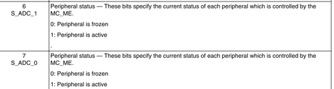

Verify that your ADC is correctly clocked before write to it.
38.3.17 Peripheral Status Register 0 (MC_ME_PS0)
This register provides the status of the peripherals.
Other than missing clocks, register protection or XBAR access right I do not see any issues.

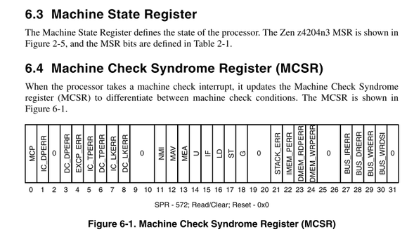

But since you will end up in IVOR1 you can track it trough core registers: (see core reference manual)
